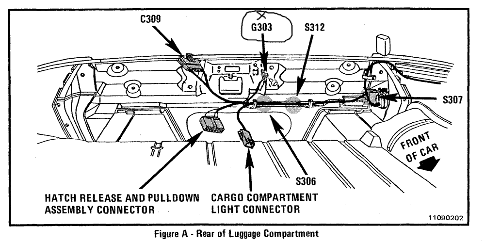

Turns out my turn signals in back arent working, brake lights arent working, and tail lights arent working. Checked the fuses and they're all good. I havnt cut any wires since the last time they worked, all i've done was installed my z28 wing and new carb studs..... I'm no electrical guy (Yet....reading a few books hopefully to expand my knowledge), but for all the lights to suddenly stop working but still good fuses? wtf? I even tried using a multimeter to make sure that power was getting to the fuses, and there was certainly power getting there, so i dunno what to do! Thanks,

Since you say that all your fuses are good and there is power going there. There is only one thing that all those lights have in common, that is the ground wire located under the center trim piece in the rear cargo compartment.

It is the item circled and marked with an "X" in the picture here. Happy Hunting!!!!!!!!!!

****. I may have disconnected that the other day when i was pissed off with my hatch motor not working, so i just disconnected all the wires and shoved them behind one of the panels (oops!)
I'll have to go dig it out....
you wouldnt happen to know what color wire it is, would you? Thanks a BUNCH!

Would you believe BLACK!!!!!!!!!!!!!!!!?
