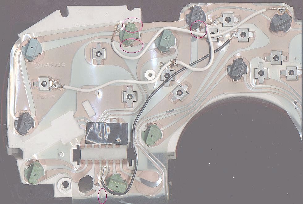

Is if possible to change the light in the gauges, if you can post pics.

yes its possible I dont have pics but I can explain the best I can
take the gauges out look on the back there are the plastic piece that sticks up about a 1/4 of an inch that is the light turn it 1/4 of a turn it should come out I hope this is some help

Here is a picture of the back of the cluster to show you what the light sockets look like. Note the light green and darker looking round items in the picture. As mentioned in 1987GTAowner's post, they are easy to change out. A 1/4 turn and the socket comes out. Please note that on some models, particularly the newer models, the bulbs are a part of the socket and can only be changed as a whole unit.
