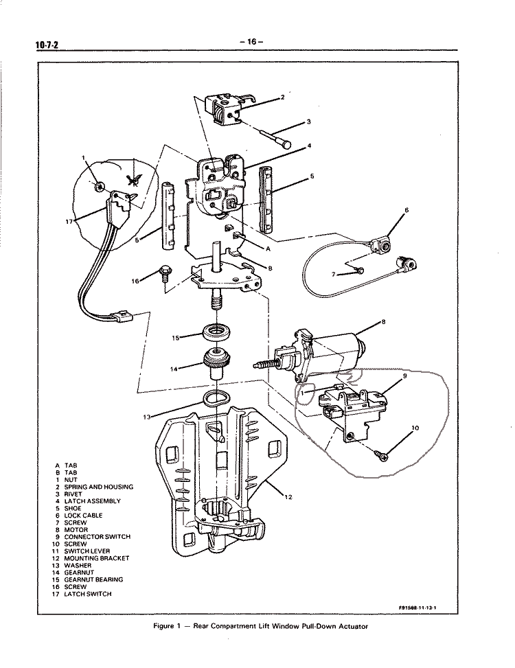

Here is a breakdown picture of the hatch motor assembly. The switch that you have questions about is the item numbered #17 and is circled on the left side of the picture.
Is this the reversing switch?That is what i usually push to get the motor to go back down but it isnt working.Just makes a buzzing sound on my power supply

Yes that is a reversing switch, push down on it and the motor goes down. Release it and the motor goes up. One thing that you might want to look at is the motor mount housing. Mine was cracked and broken around the screw attachment points. It would pull the hatch down to a certain degree but not all the way and almost burned up the motor. Another thing to look at is just replacing that switch.
