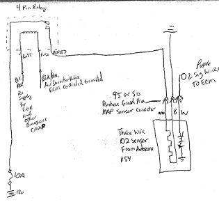

I recently put a heated 02 sensor on my headers if any one is interested i'll draw it up

here it is if you cant read it i'll email a larger scan, I am using the AIR DIV SOL wire to allow the ecm to control it, im not sure if it get quite hot enough before the computer shuts it off. if you find a better way to control it lemme know. I still consider this experimental on my part. Some people have them hooked up to their fan relays, this seems a little @$$backerds to me so i tried it like this, it'll go into closed loop in 3-5 min depending on engine temp. you can control it however you want by changing how you ground pin 86 on the relay.
