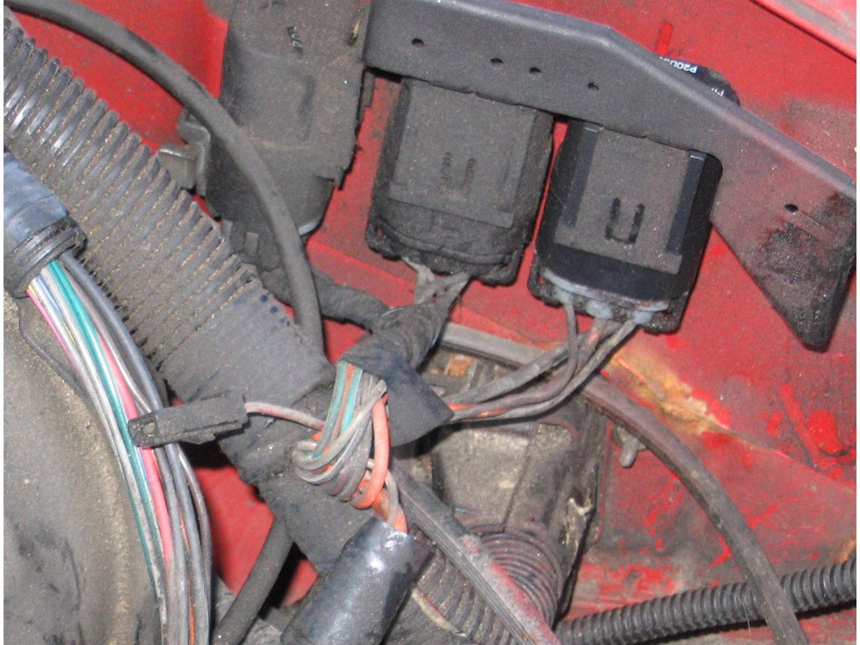

Hi.
Could someone identify the connector by the fuses. It doesnt seem to have a home.
Also on another note, just to confirm, which fuse in the background is for the fuel pump?

Fuel pump test lead. This wire can be used to send power to the fuel pump for testing purposes. I believe the relay closest to the engine is usually the fuel pump relay. The fuse for the fuel pump/ECM is in a weatherpack connector near the battery.

Thanks for the info Bingo. I should have used the word "relay" instead of "fuse". I'm goint to tap into it to ignition power my heated O2. I've searched and found that it is a pretty safe bet to go with.

I ran ignition power for a shift light off one of the relays with a scotch lock connector. It worked very well. Ignition hot will be pink with a black stripe,
