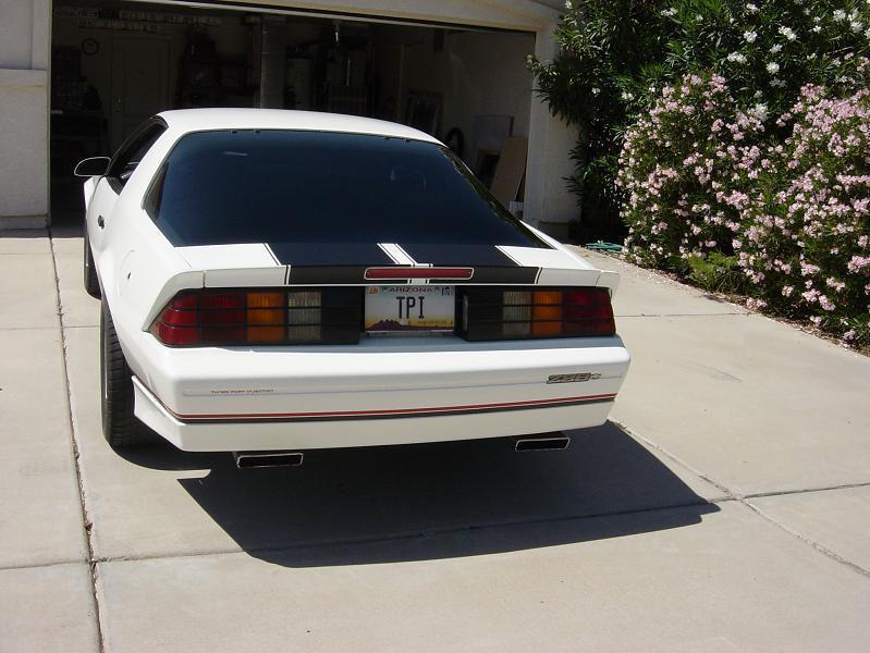

Yes, one of the "messy" jobs is removing the tank. I've done this dozens of times. You'll also have to lower the exhaust too. I can describe the complete process including some hints if you can call me. I'm in Tucson. The process is kind of lengthy and I'm just too lazy to type it all here. PM me and I'll give you my numbers or if you want, I can buzz you.
BTW, your member name and my plate are identical...!!!

Hahaha crazy, nice car
