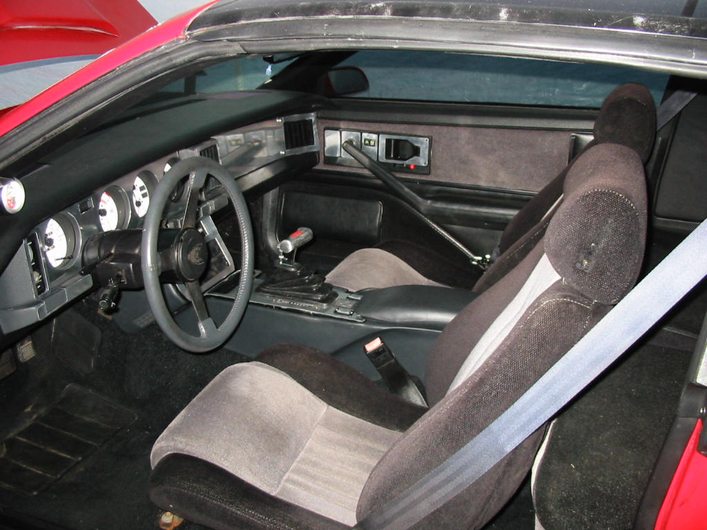

This is a father son project that is just completing and this is one of those loss ends that needs attention. Here are some before and after shoots.
