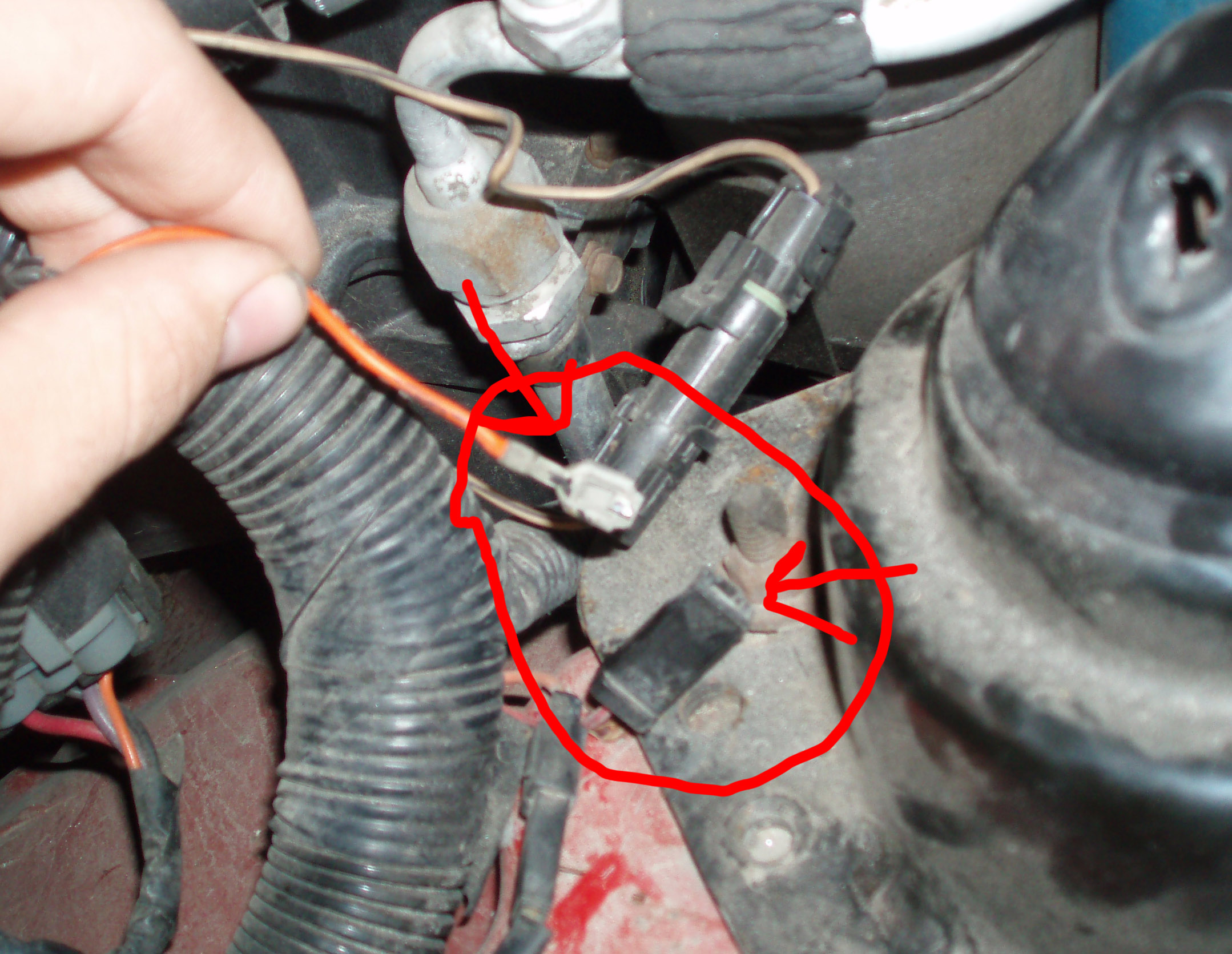

Hey guys! I have a 91' Camaro RS with a 305 in it and I just found a wire in the upper left corner of the engine that is not connected. When I first connect the wire a buzzing noise will come out of something right about the fuel tank. I can not see what it is. Does anyone know what the wire could go to?

Here are some pictures. sorry if the quality is bad. In one picture it shows the wires and in the other it shows where the wires are located in the engine.

the only wire i could find that color (that was in the open) was the one going to the heater motor realy. and i see by your pics that is still hooked up.

The orange wire goes to the hood light. The red one is the test wire for the fuel pump. When you add power to the fuel pump test wire it runs the pump. They do not hook together.

thats why i couldn't find it. i took out my hood light.
