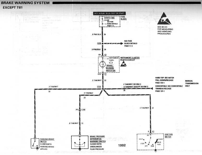

I did a auto to manual swap and for some weird reason my e-brake idiot light won't go out even when my brake handle is all the way down. I couldn't find the wire schematic that shows what the green wire and brown wire connected to on my auto shifter but now their not connected. Anybody have info?

I believe the green wire is for the hatch release switch. You can connect it to the tan/white parking brake wire.
The light might be triggered by the parking brake switch (could be grounded), by the brake pressure switch (could be faulty) or the tan/white wire could be simply pinched somewhere and grounded accidentally.
See the diagram below.
