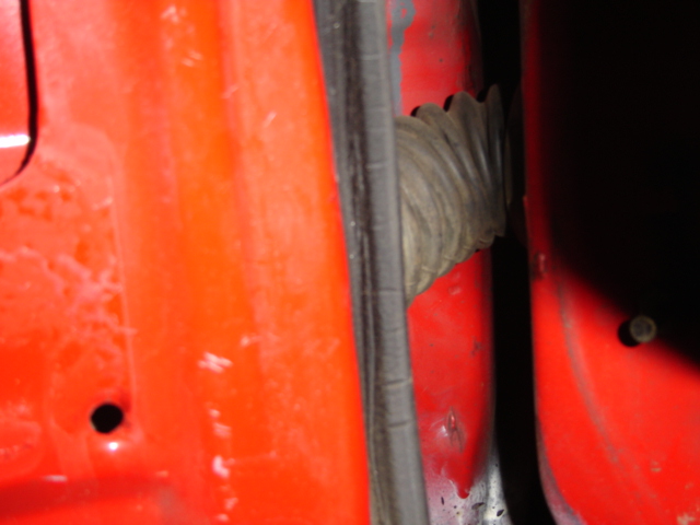

yes that will, notice those rubber boot that run between door and body inbetween the two door hinges, that is where you run the wires into the body, so that is a plus!!
Old Nov 27, 2007 | 05:18 PM

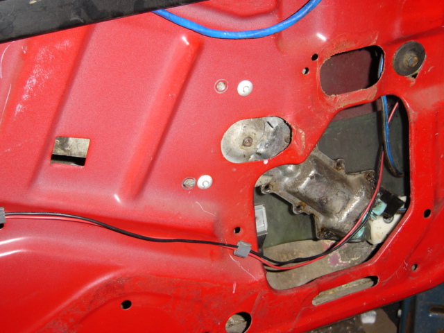

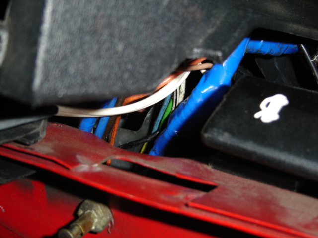

As promised, First pic far corner of door where actuator is and wiring starts, 2nd pic is middle of the door where wire runs (stock location of wire), 3th pic is the rubber boot the wires come through, 4th pic is where the wires come into the car, and 5th pic is the fuse block, notice the 3 empty spots on the right side that makes an opposite L compared to the other side, is should say BAT, those are 3 points that you can get power for your accesories, just use a male spade solderless connector in there and you should be all set once you find a place to ground it out. Hope this helps and if you need anything else, let me know!
Attached Thumbnails power door locks-dsc01236.jpg   power door locks-dsc01238.jpg   power door locks-dsc01239.jpg

4th and 5th pics
Attached Thumbnails power door locks-dsc01240.jpg   power door locks-dsc01241.jpg

I have a remote start/keyless entry system on my 87 Trans Am... It was actually much easier to install than I thought... But then again, my car came with electric door locks, so I just hooked up the system to the relays on the kick panel... I have one spare working door lock actuator thats yours if you pay shipping. One of my locks was stubborn and I thought I had to replace the actuator, but all it needed was to be soaked in WD-40!... I used a kit off ebay, but I went with one by Directed Electronics which also makes Viper alarms, so its a reputable company. I've had it for a couple of months with immense success. Specially now thats its cold. I wake up, go to the window and remote start the car, then go brush my teeth and eat breakfast and when I get into the car, its nice and warm (since I'll leave the heater on)... Check the vid in the sig for the remote start and keyless entry demo... If you need more info, let me know, I'm happy to help... FYI: the kit is Boa 265B and its like avg$30 on ebay...

thx for those pics man im going to order that ebay keyless entrysystem right now ill let you guys know how it turned out. that keyless entry system you got is awesome man i might order that to while im at it.
