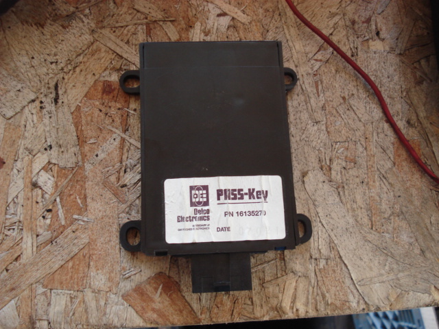

Where is the VATS box located on 92 camaro?

it's behind the windshield defrost vent on the passenger side. you have to unbolt the entire dash to get to it. i had to replace mine on my 1991 z28 camaro. here are some pictures. hope this helps
Attached Thumbnails VATS Box-dsc06268.jpg   VATS Box-dsc06271.jpg   VATS Box-dsc06264.jpg

a few more

thanks for the info and pictures that will help me on my project.
