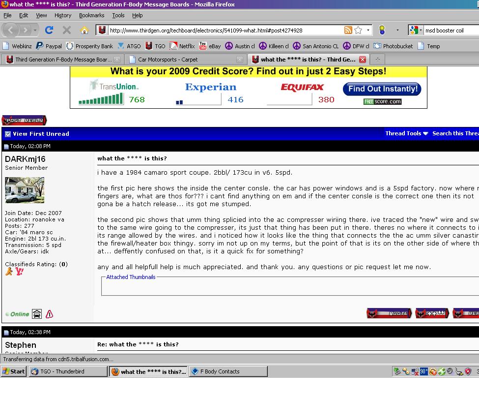

I see the box for pics, but nothing in it......
