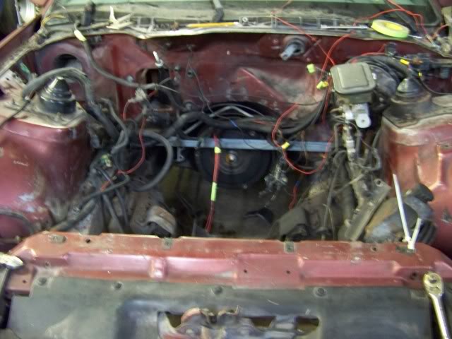

my car is a 1987 camaro it has been a carb car since i got it but my wire harness has been a mess. i have just pulled the motor for the first time and I'm trying to clean the bay up new paint got rid of the ac but going to put the blower back in so i can have heat.this weekend I'm going to try to get rid of all the wires that i don't need have a Friend that is going to help me and he seems to know what he is doing but I'm scared as hell. at this point i think all i need is all of the main power to the battery power to my alternator power to my distributor the wires that go to my 700r4 and the wires for the blower motor. the harness that goes to my head lights seem to be all in 1 so will not mess with that at all. if you guys have some tips or know of something that i should not get rid of id really appreciate it.

If it still has the Oil Pressure Switch on the back of the manifold, it would be a good idea to leave that on there as it cuts fuel to the engine in case of loss of oil pressure to prevent engine damage.

nah its never had that since i have had it. the 305 i just took out of it has Edelbrock carb intake and headers
Wrong
The oil pressure switch TURNS ON the fuel pump once oil pressure is over 4 psi.In any case it is in parallel with the fuel pump relay so one or the other would keep fuel to the engine regardless of what oil pressure is

The large wire bundle that comes out of the pass side fenderwell - all of that can go - every last wire. So, you can unplug from inside the car, take the plastic fenderwell cover out of the wheel well, and disconnect the entire bundle from the outside, and chuck it. Leave everything from the driver side in tact, and leave the few wires beside the heater blower assembly in tact.
Unless the PO installed a torque converter lockup system, your TC is not locking, so you're losing fuel economy and running your tranny too warm at highway speeds - get something to lock your TC as well.

cool ty

this job is done looks good
