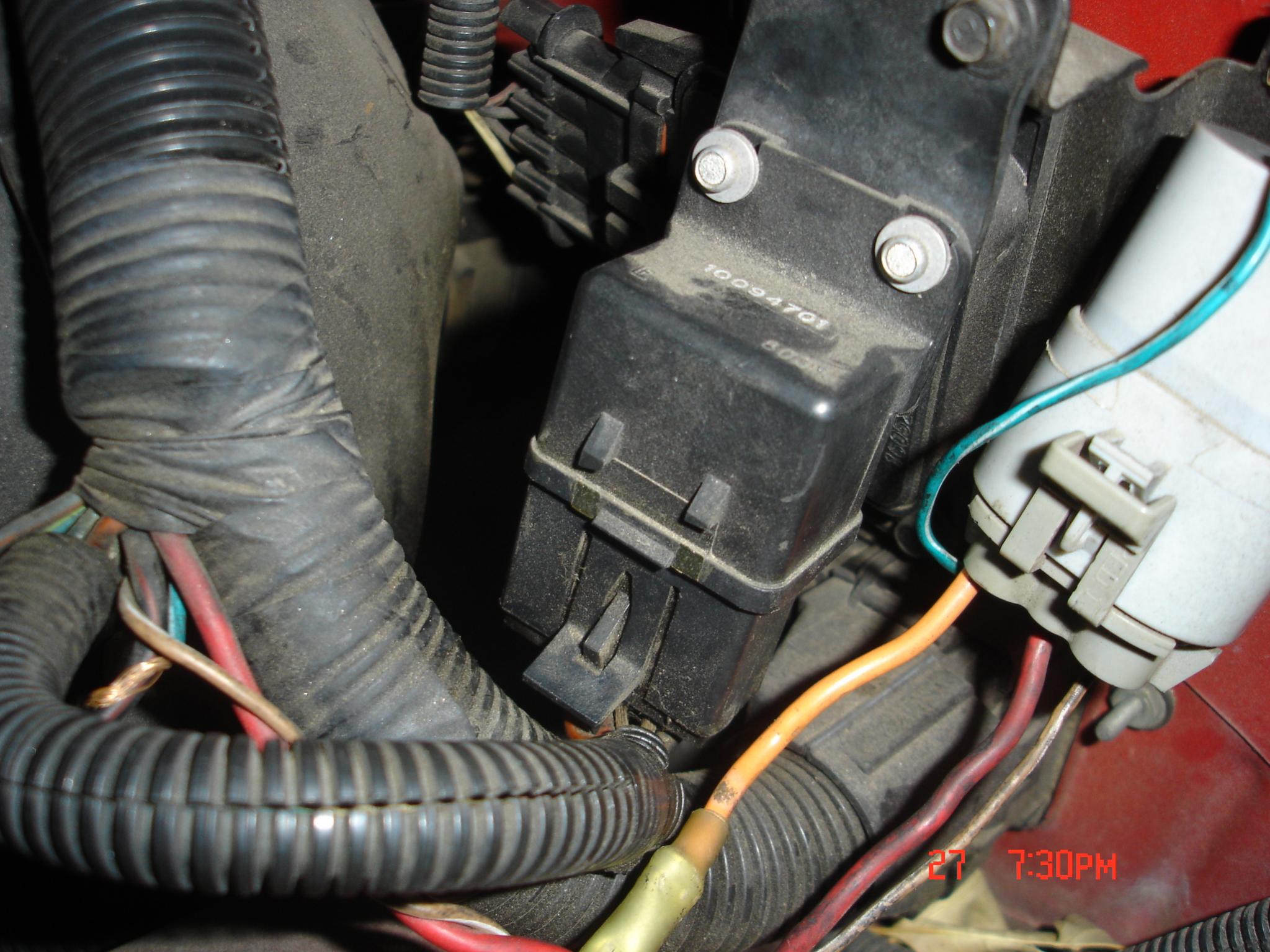

Its a nice sized gauge, I dont remember where mine was exactly on the stock harness, but its probably the one on the passenger side loom.

The one in the loom on the passenger side is a pretty small gauge, I'd say 16 or 18, it looks like an interior wire, to be honest.

My harness has been highly modified, but the starter wire is the stock one. You can see where I spliced in the (red) wire to run to the battery. It works great when working under the hood alone and you need to pump the starter.

So that's near the firewall, back of the engine bay passenger side?

It runs down to the starter right around there on a stock harness. But yea the pic is the firewall, right were the heater lines come out.

ok i think i found it ill try the jump tomorrow in the meantime, whats this black box? cuz everytime i turn the key to crank it clicks really loud, is this the starter relay?I think VATS problem, not sure-dsc01980.jpgI think VATS problem, not sure-dsc01981.jpg

Its a relay, but Im not sure which one. Clicking is normal.
