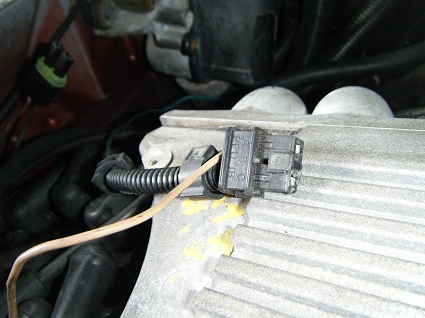

This is driving me nuts where do hese wires go. I found one that pluged into the IAT under the plenum the others just dont know. The are all at the back of the engine coming out of the main harness. Heres a little more detail.
1st wire is just a small tan wire-no stripe. It has been spliced together by someone maybe it was cut at some point. It is located just behind and a little to the left of the distributor. It goes into the main harness from the ECM there. after lookng at this a little further it appears that this wire was cut from a connector on the other side of the engine (drivers side). It comes out of the main harness as well. Its a square connector has one green and then the tan wire out the back of the connector.
2nd wire is just a green wire-no stripe (a little heavier wire than the tan one) it has a single male connector on the end. It also goes into the maoin harness from the ECM in the same place as the tan wire.
The 1st and 2nd wires seem to naturally lay on the passenger side of the distributor. Again this lone tan wire seems to be part of this square connectorIll explain in a second.
3rd wire is a double wire (I guess I should actually call this a connector) it has 2 wire going into a double male connector. One wire is pink-black stripe and then the second wire is black. It goes into the main harness from the ECM behind the distrubutor on the drivers side. It seems that this wire wants to lay naturally to the drivers side of the car.
Last Wires these go into a square connector tht comnes out of the main harness on the drivers side of the car. It appears that someone cut the tan wire and brought it over to the passenger side for some reason.but if I hol the tan wire to gether with the tan wire sticking out of the back of that connector it matches up perfectly so Im calling this the correct place for the wire. tan wire comes from that same main harness that runs behind the engine.
The 2nd pic I was just trying to show where the 2 wires entered the harness.

ASE Doc helped me find the middle pic. We are 99.9% sure it goes to the EGR Temp Sensor.

Well the last picture looks like it might go to the manifold air temp sensor located on the bottom side of the plenum chamber. Have you checked to see if that first picture might go to the winshield wiper motor?

I have the same problem. I did a 350 swap and I’m putting it back in now and I don’t know where this tan and black wire harness goes. Is it not needed? One of the plugs was full of debris so I’m thinking it was open ended. I did not label it when I pulled it out so that would further that assumption. But it’s so jampacked in there I don’t wanna have to go fishing for it and tear everything out again.
