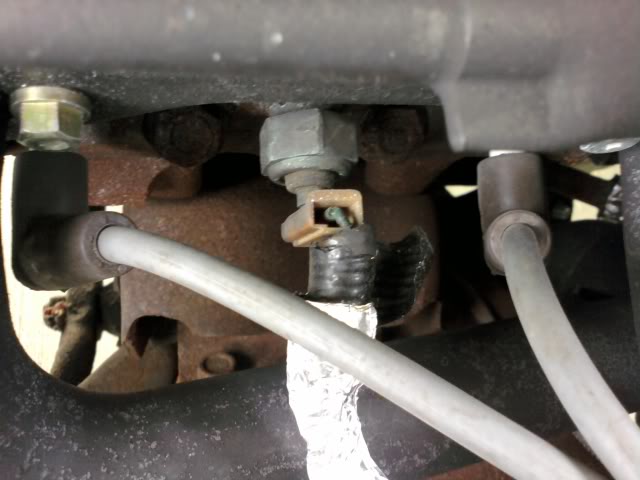

Re: twitching temp gauge
this is the wire you are talking about, correct? after looking at it closer, it doesn't appear to be in such good looking shape, maybe that might be the issue. the wire looks streched to me.
