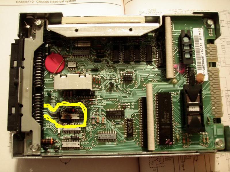

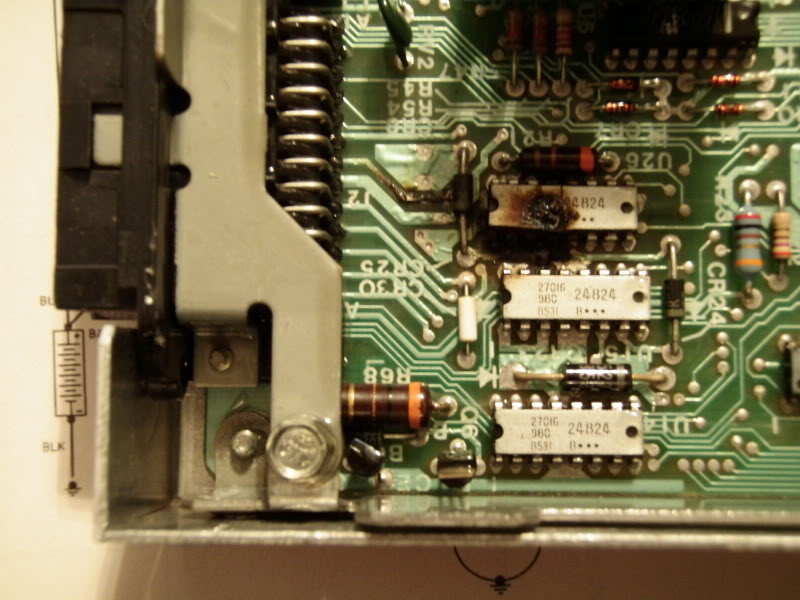

Need help identifying what this part of the computer controls lookin inside
Ok so I took my computer apart and this is what I found making smoke. ANybody know what part of the car this section of the computer controls? Its out of an 86 firebird 2.8 v6

That ECM is done for, find a replacement, luckily the 165;s are uber common
Now to ID the problem, do a continuity test from the cooked printed path to it's corresponding ECM terminal. Then compare the ECM pin to a wiring pinout. Once you find what it related to you should be able to determine where the short is
