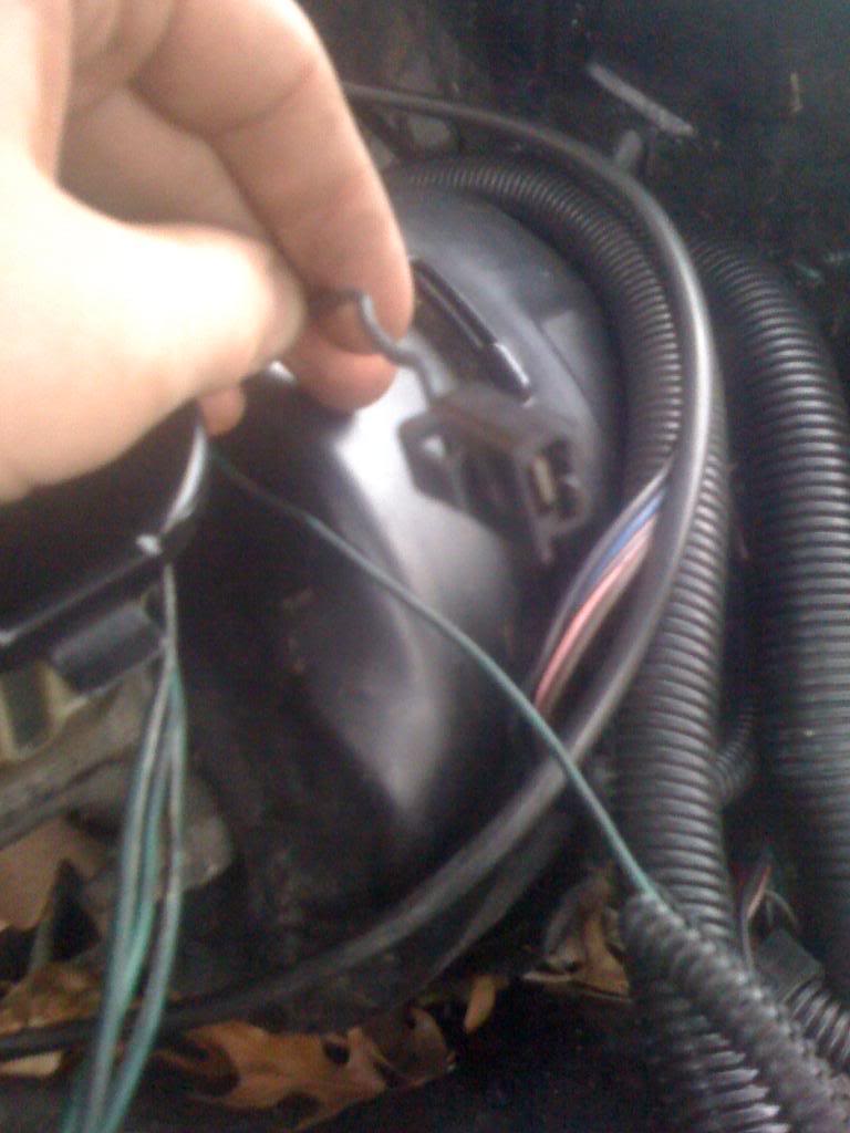

Hi, not sure which of these wires are for what. This is all on the driver side all in the same wire loom.
1st pic : a/c wire? 1drkgreen/whites stripe the other wire is black (the one that's broken off..).. where does that go?

1st appears to connect to the compressor.
3rd appears to go to the throttle kicker.

1st a/c comp(trace the grn wires route & see if the rest of the blk wire is there) probably a grd though.
4th is for the distributor
