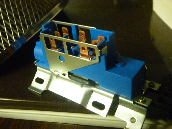

i went to autozone, i bought a new key ignition cylinder, a new ignition STARTER switch, and also a new B&M safty lock switch for my shifter.

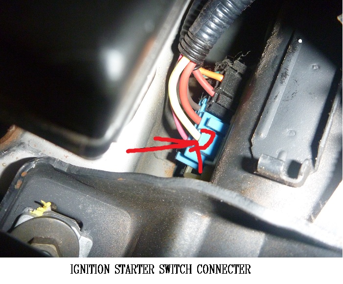

i got the car started so rules out my hei, msd box, starter, and battery cables)n i used a jumper wire on my trans safty park switch, the car started right up and ran well. so i tested the 4 wires that connect to the safty park switch and they all get power besides the THINK 10/8 gage GREEN WIRE.
so i went under my dash and started testing wires, those thick 10/8 gage wires that comes out of the streering column connects to the IGNITION STARTER SWITCH, i tested all the wires( YELLOW, ORANGE,PINK,BROWN, TWO REDS, GREEN ) they all get power EXCEPT the YELLOW wire. the only time the yellow wire gets power is when i turn the key...does that rule out my IGNITION KEY CYLINDER???? i think it does but i could be wrong.( see picture)
well i followed them wires that go into a relay( i think its the starter relay) and all the wires get power except the thick green wire that i believe goes to the trans safty park switch.....(see picture)
i did not put the ignition key clyinder or the ignition starter switch in yet, because could this have to do with VATS? ( so i can safe money and return the parts i dont need, and the ignition starter switch looks like a B**** and have no clue how to get to it.
keep in mind i dont have a ECU, the car has a 79 chevy engine with a manual fuel pump, hei and msd box....but i got the car started from jumping the trans safty switch, so i dont know.....
the 3 pics attached is
-the yellow wire from steering column that gets power when i turn key
- what i think is the starter relay (please correct me if wrong)(green wire getting now power to it)
- the new ignition starter switch, must be impossible to install.
Attached Thumbnails CAR WONT START!!!! NEED HELP-ign-starter-switch-connecter   CAR WONT START!!!! NEED HELP-starter-relay-1.jpg   CAR WONT START!!!! NEED HELP-ign-starter-switch-1.jpg

also what is this wire going into the ignition starter switch ( circled in red)
- 2nd one is a relay which i have no clue what it is...( what is it?)
- please help and thank you for your time.
