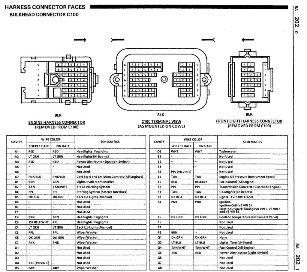

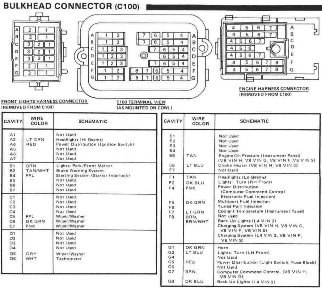

i have a 1986 trans-am that originaly came with a 305 tpi i took the motor out a long with the wiring harness and ECM and i droped in a 1989 350 tpi with '89 ECM and '89 wiring harness i heard u would need to repin the connector at the bulkhead connector i dont know wich ones and need help i got some diagrams on google pics and here they are
this is the 87 body year

this is for the 89 body year
