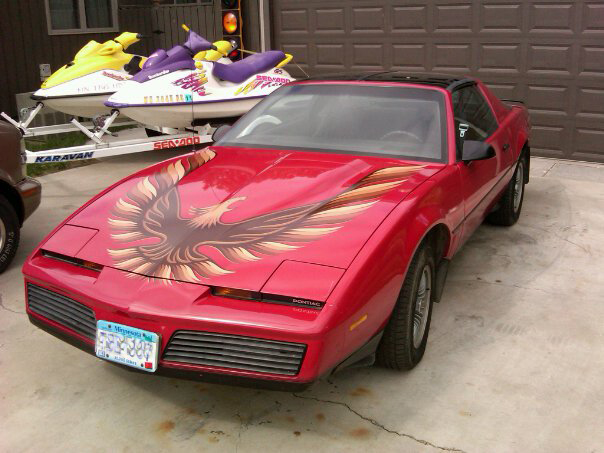

Hi all, this is my first post here.
I'm from St. Paul, Minnesota.
I bought a very nice '82 Trans Am a couple months ago and have been going through it, fixing some minor stuff.
