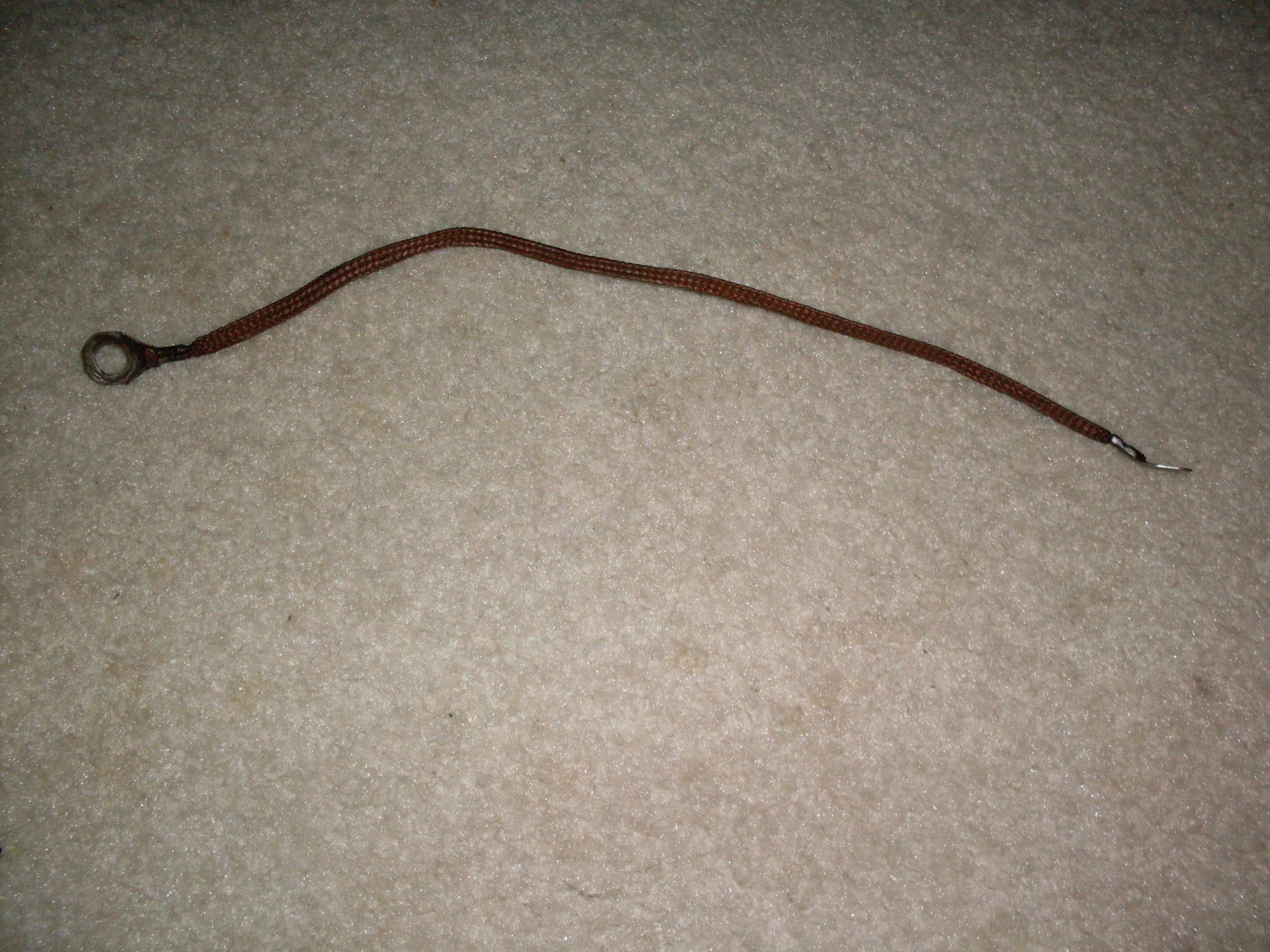

The wire coming out of the starter motor is a braided wire with a right-angled loop terminal on the end. Comes right out of the top of the motor housing. Generally gray or black, depending on what color the starter is painted, or can be copper colored if damaged or green if corroded.
I don't have a pic of mine to show you how it gets hooked up, and I can't exactly hook up the wires right now for a pic as the starter isn't attached to the engine and nothing is attached to the body of the car .

HMM thats weird, i never noticed that wire. Its actually coming out of the motor or the solenoid? Now ill go look again for that wire, but if i dont have it on the starter am i introuble? Or can i do something to fix it? Also if i do find that wire, where does it go to from the starter?

It's about half an inch from the tail of the solenoid, towards the other end from the flywheel end of the starter. It comes out of the motor and is bolted to the solenoid at the bottom terminal.
Define "no power"... Does the rest of the car have power and the starter isn't running, or does nothing work?

Oh are you meaning this?

By no power i mean when we put the key in the brake light came on, turn signals worked. When we went to the start position we got nothing. Were going to redo the wiring in the back for the fuel pump so ill update on that part later. For now were trying to get the starter to engauge when the keys in. So far what we ended the night off was testing a little. When i had the key to the on position the purple wire had power. When i turned it to the off position it had no power. Everything was connected exactly how you said it, except that braided wire. We couldnt figure out why it wasnt working

Re: Help getting engine harness connected
Nevermind, its there and connected.
