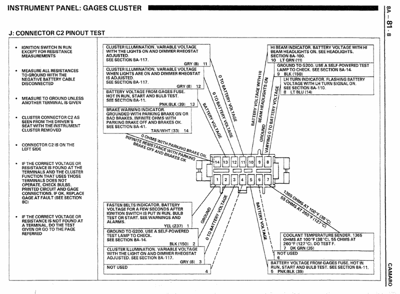

I taped into a 12v switched wire in the back of my cluster wiring. It was pretty easy to do and it looks clean as you cant even see it
heres the diagrams of the 2 plugs in the back of the cluster if you do it that way
