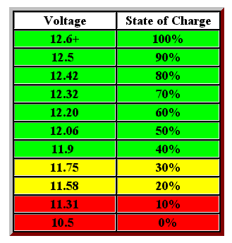

I would take the reading directly at the battery terminals with the engine running to get a good reading, and not put too much faith in the gauge meter. You should have ~14.5 volts when the engine is running.
I replaced the dinky CS130 alternator with a beefy CS144 140 amp alternator and absolutely love the upgrade. All my Camaros and my dads truck all have the upgrade now.
How do you know the alternator isnt charging the battery?

Just test drove it. Seemed like it was ok. Took a reading directly at the battery. 11v at the highest, then drove it. Went to take a reading again and it had gone down to 9v. Then let it sit, and turned it off. Turned it on again and the dash said it was back at around 11. The alternator doesn't seem to be working because the battery isn't getting charged like it should, if at all. Even when I rev it to like 4500rpm it doesn't seem to be charging right if at all. Any more help would be awesome. Thanks guys!

Thanks for the chart by the way.

Forget the alt for the moment, the battery can't be that low (at the terminals) unless it's flat, broken, shorted, or under a huge constant load (like starter motor cranking). Swap batteries.
