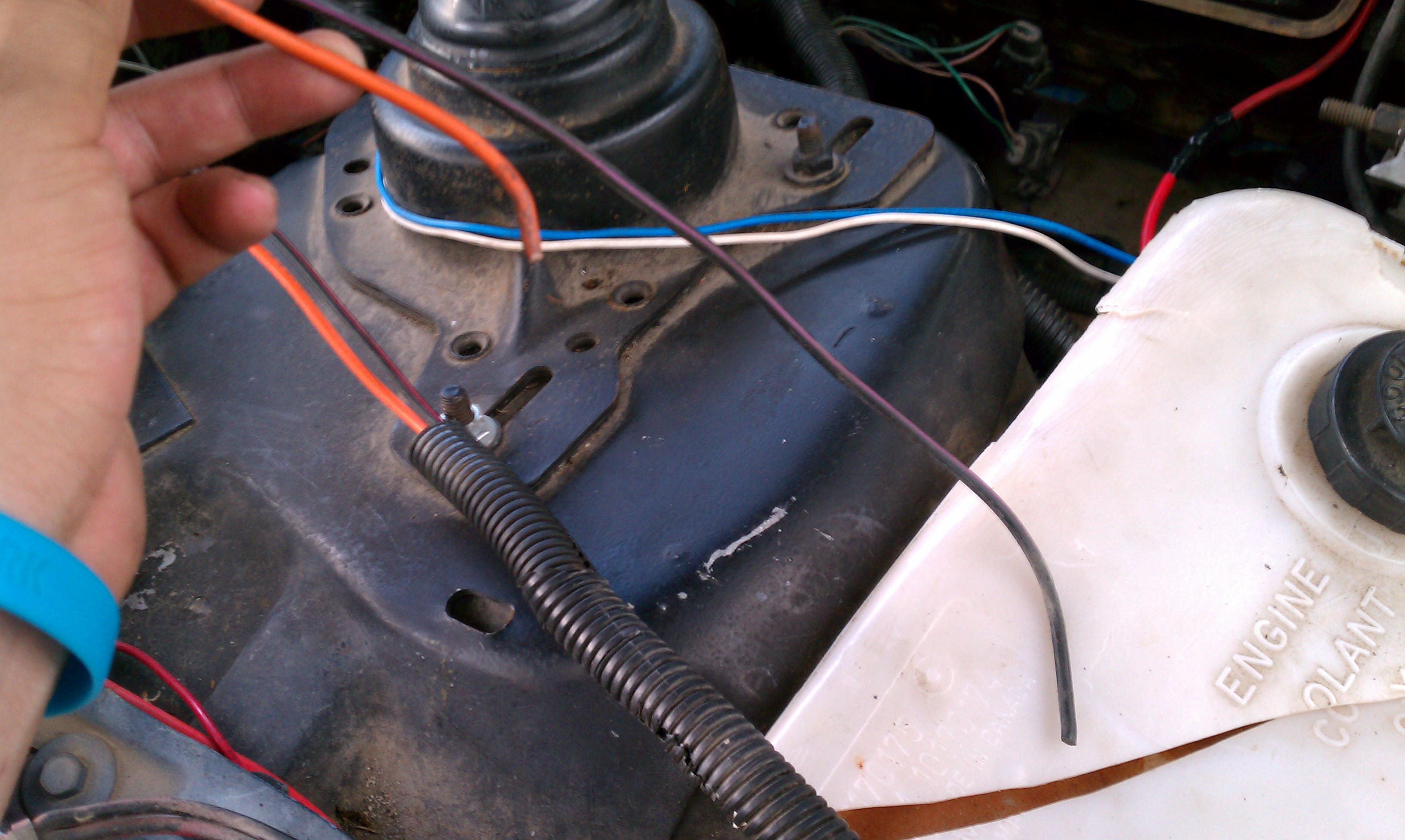

ok here it goes.... I have a 89 camaro with a 92 lo3, I just changed the heads and intake it will now be a tpi (sd) also from a 92, I tied the tbi fuse link into the tpi harness and now my fan wont turn on.. I had the fan set to turn when ignition is on, also the fuel pump wasn't priming?, everything else works fine.
i had a extra orange wire and black with purple stripe left over?? the other orange went with the fuse link??
also I haven't connected any of the small wires yet near the brake booster....
any advice would be great thanks!!
Attached Thumbnails Wiring Problems?? (engine bay harness)-imag0012.jpg   Wiring Problems?? (engine bay harness)-imag0011.jpg

you need to trace the relay wires and make sure you have power and good ground(s) for the fan. You also need to look at some wiring diagrams, check out http://www.austinthirdgen.org/index.php?pid=19

I got all the diagrams I'm just not understanding the fan and fuel set up its like tied in to one another

If you don't understand the diagrams, learn them, or find a person to help you. Until then your best bet is to physically trace the wires and check for power. You can start by disconnecting the relay and check for power at the socket.

Will do, I think its going to be a long weekend..
I will post some more picture s Sunday night and let y'all know how it went thanks a lot for the feed back so quickly
