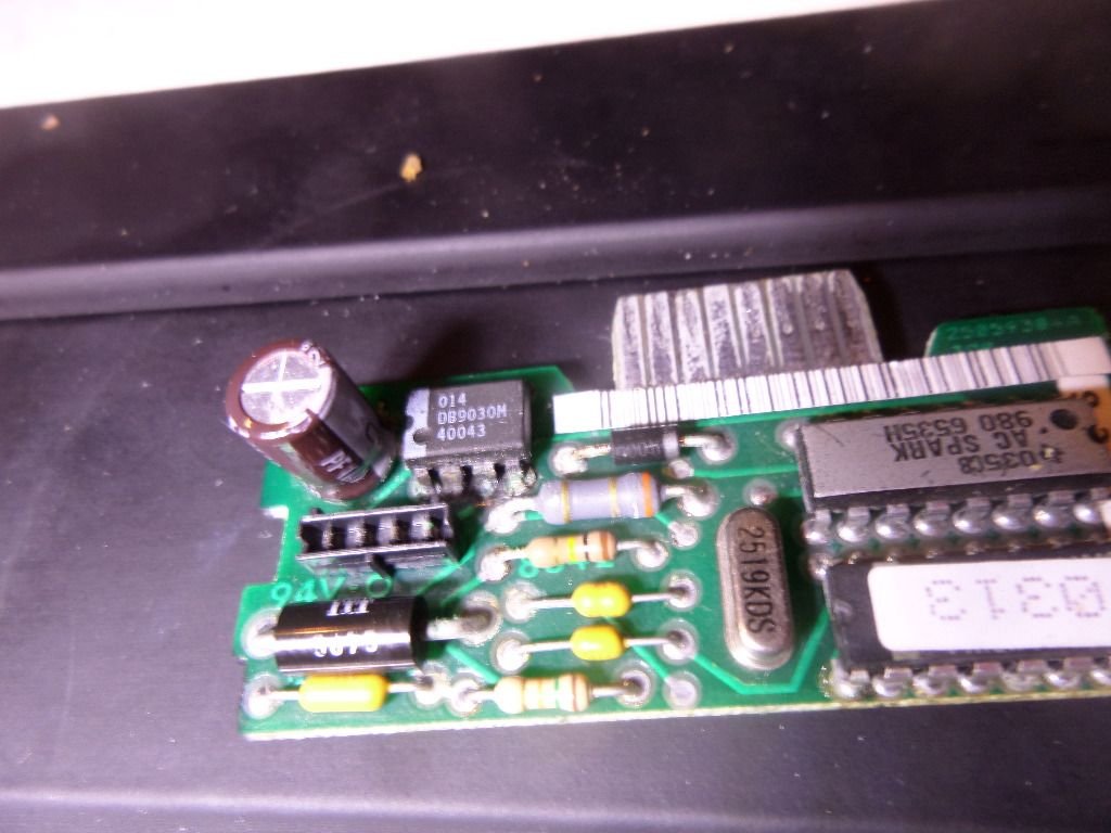

First off, I'd like to say thanks to the members for contributing to this thread. It has been very informative.
In the interest of passing on knowledge, I will add a few things which users may find helpful
Before my speedometer failed, it began to jump around and then completely died. My first thought was the speed sensor in the tail housing of the trans. Not wanting to take a chance and spend $80 on a replacement, i watched a clip on youtube on how to test these. The test involves hooking the sensor to a drill and monitoring the AC voltage as you spin it up.
I tried this and it did indeed produce AC voltage. From there, I felt it was good and proceeded to test other components as outlined in this thread.
guess what the problem was ?? The speed sensor which I thought was good ! !
Even though it produced AC voltage, it was eratic and the speedometer did not like it.
I feel the best way to test the speed sensor is to remove it from the trans and spin it with a drill while the connector is still hooked up. Ignition on, trans in neutral. hold the drill at a constant speed and note the speedometer. My faulty unit would make the needle move but it jumped up and down and took a lot of speed to see movement. The new sensor took less drill speed and held the needle constant.
Another test is to hook up a scan tool to the ecm and monitor the vehicle speed with the scanner. If you are reading 0 mph while driving, it's either the speed sensor or the wiring between it and the ecm.
by the way, my vehicile is a 91 camaro with a 305 tbi and has the external speed buffer. Its located next to the ecm directly behind the dashboard. I've attached some pictures

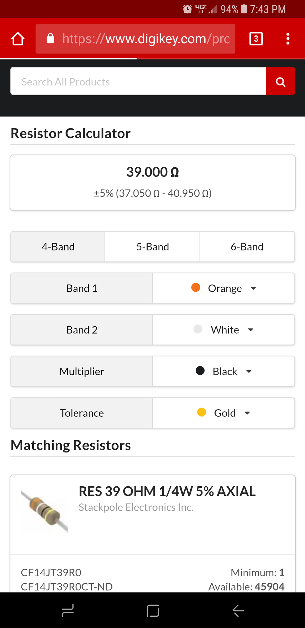

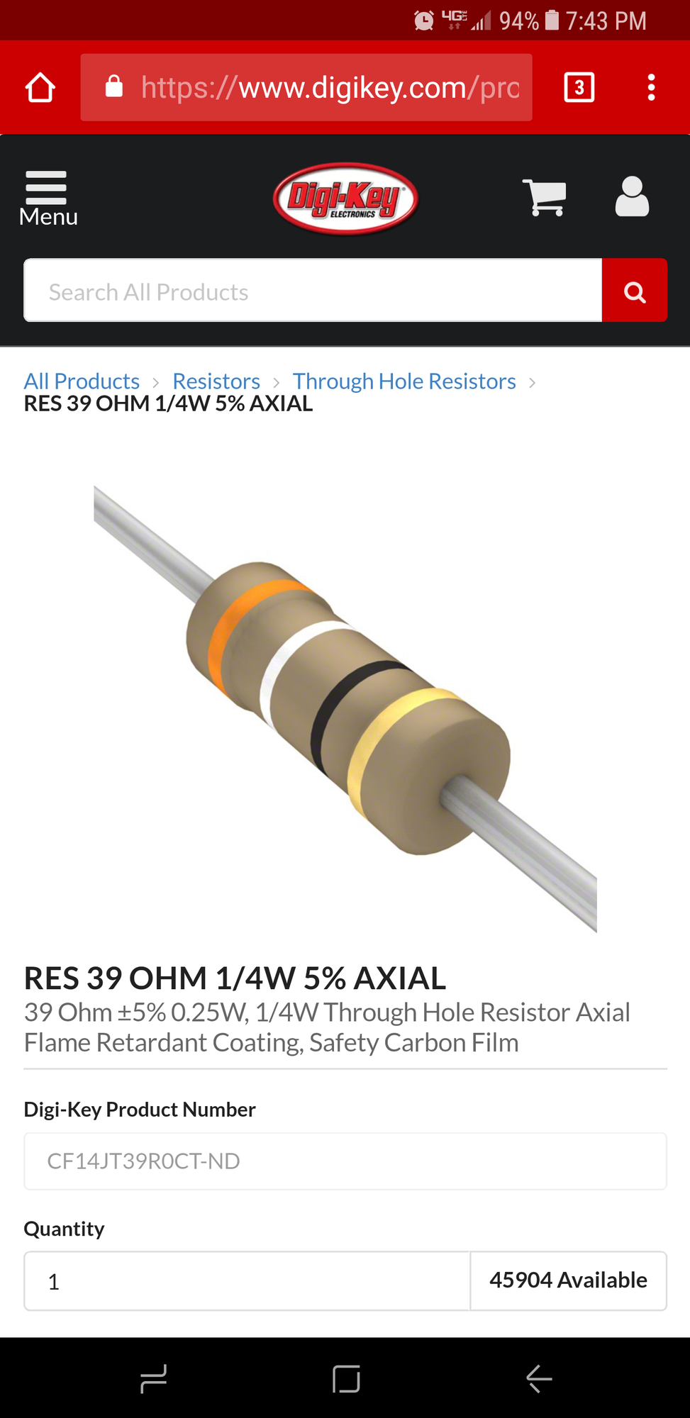

​​​​​​Figured I better jump in and correct this before someone else tries it. The resistor identified as 30 ohm is actually a 3.9 ohm.
If I remembwr correctly the resistor was a 4 band although in the picture it seems to be a 3 band and the color code was ,orange, brown, blue, gold. For what ever reason the shoty camera that I used didn't pick up on of the band, if I still have that old resistor laying around I double check it.
Hmm, well I'd be a fool, that darn thing is 3.9ohm. Im very surprised I didn't catch that myself or even go back and check after a few others mentioned it as well. I'm not going to complain though, I haven't had any issues what so ever in 60k miles, maybe one day if it stops working again I'll change it to 3.9ohm but for now it's perfect. The only thing that makes me curious about it is I waunder with a lower resistance if the needle is able to react to speed changes more quickly, this might be a good thing to use a pot on to see how more or less resistance effects the needle.

I replaced the resistor in my speedo board of my 91 RS, it read as open on my multimeter. It looks like a 39 ohm, the white band was flaking off. I replaced it with a 3 watt 39 ohm that I got out of an old tv. Speedo still does not work, the resistor now gets very hot. I have an EBL Flash ECM and speedo works fine from the ecm thru the laptop. Could this mean I have a shorted speedometer or buffer?
Not sure where to go from here.
Thanks

The resistor is 3.9 Ohm, NOT 39 Ohm. Also, check for any bad cpacitors. I had to replace one bad cap and the 3.9 ohm resistor.

The resistor should be 3.9ohm not 39ohm, i beleive i either made a typo or actually put 30ohm on mine when i created the thread. Either way mine still works flawlessly, but still put a 3.9ohm in place as others after me did amd check for bad capacitors as i had to replace one myself. If the ecm is reading mph as it should be that meand that your speed sensor is working and so is your buffer maybe. The speed sensor creates AC (alternating current) and if i remember correctly the speedometer or the ecm receives the ac voltage and turns it into DC (direct current). I will have to lool back at my notes as i havent touched mine since i fixed it.

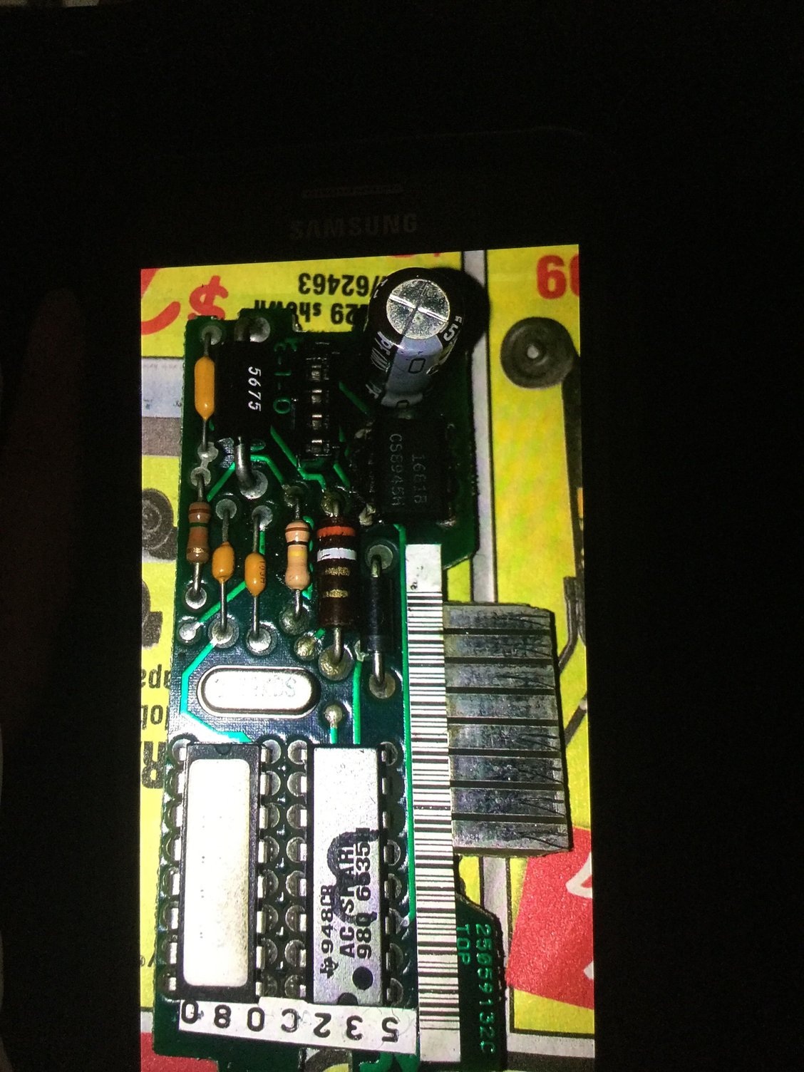

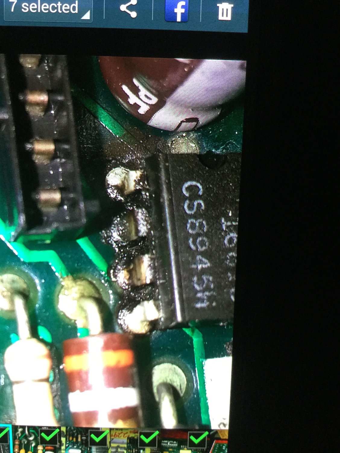

Originally Posted by Crazy Eddie
Add another thank you to the list!
I was able to fix the tach on my 91 RS but then the speedometer started going out intermittently. Now it's at zero more often than anything else. Going to try cleaning up that chip and test all the resistors. I don't remember what it tested at but it's another example of a 3.9 ohm resistor.
I have a Teal 1991 B4C with a bad Speedometer Board that looks like yours, see attached. I have contacted all references in this post, including Hanks, and cannot find one. Does anyone know where to get one?
Did the cleanup on the corrosion on the IC chip beside the capacitor work? Various Pics show the IC as a DE 9023M, CS8945H. Mine is a DB9030M. Does anyone know what this is or where to get one?
Any help finding a Speedometer Board would be appreciated.
