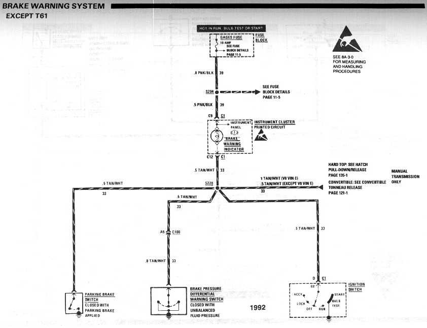

These three diagrams should give you a good idea what's going on:
brake warning system
hatch release
ACC fus
If they (the mechanics) blew your ACC fuse, the hatch release switch is backfeeding ground from the grounded accessories, through the release relay and to the brake warning system (splice S228) and into the warning lamp that lights up.
I would check the ACC fuse first.
Also, as Lon suggested, I would check the ground in the center console. If it is loose, it will work intermittently and you won't have a brake warning light with the parking brake set and you won't be able to open your hatch.
If you need more diagrams, you can find them here.
Hope this helps.
Lou
