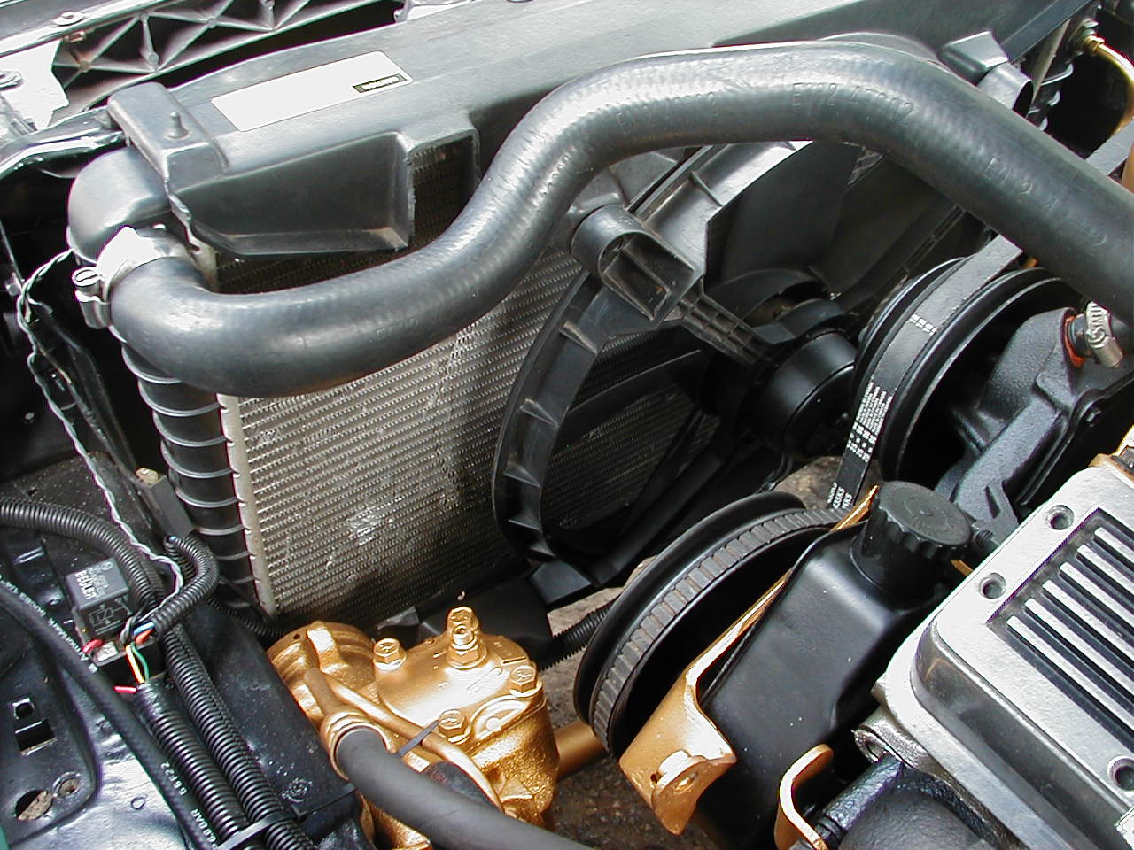

I just had to add an aftermarket fan switch because my 86 harness was from a TPI car. (TPI fan controlled by ECM). The car was converted to carb and I used a stock fan with a Hayden fan switch. ( you can see where I mounted it in this pic.
