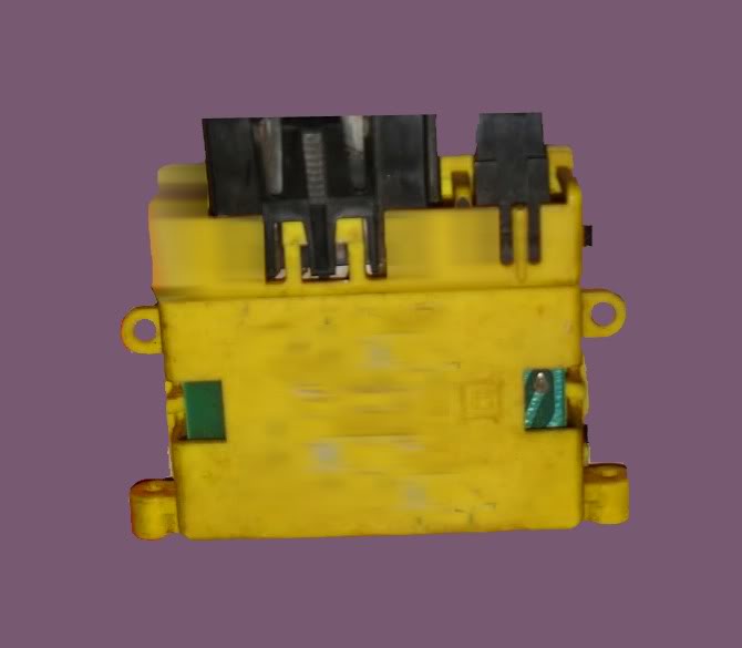

At the rear of the IP there are 2 connectors.
Make sure the pins are straight and clean.
If they are gain access to the buffer which looks like this:
It’s located behind the instrument panel at the right.
Connect an audio amplifier to terminal A
yellow wire to make sure it’s getting a steady signal.
Ground to ground, the signal wire to terminal A
yellow wire of the VSS.
With the car on jackstands listed for a hum from the amplifier when the rear wheels are rotating.
If you do, then find out if you get a hum from terminal C
tan wire.
The
tan wire then goes to the speedometer unit.
If it gets to the speedometer but the speedometer does not work, have it repaired or replace the unit.

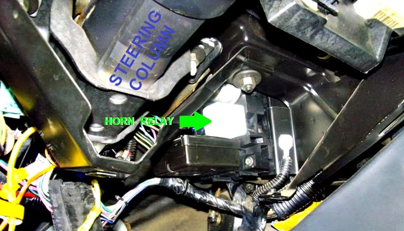

horn doesn't work
Remove the knee bolster.
The relay is to the right of the steering column.
Connect a voltmeter to pin J of the horn relay, (you can remove the relay and probe the socket which might make it easier) what is the reading on the voltmeter?
Now press the horn button on the steering wheel, now what is the reading on the voltmeter?

thanks dudes! I'll be doing some testing, vanity mirror connection is hacked, the speedo did work before my diff got replaced, same gear ratio and everything..... The fuel gauge seems to be fine and if I ground metal between the spring and the tab behind the wheel the horn goes nuts..... I also just threw in a new turn signal lever wipers still dont work. As far as the other **** ill deal with it. Im thinking the best place to start would be to have the radiator fans and radio wired back to stock and then take it from there? the gauge fuse has been reduced to a 15 for the time being
