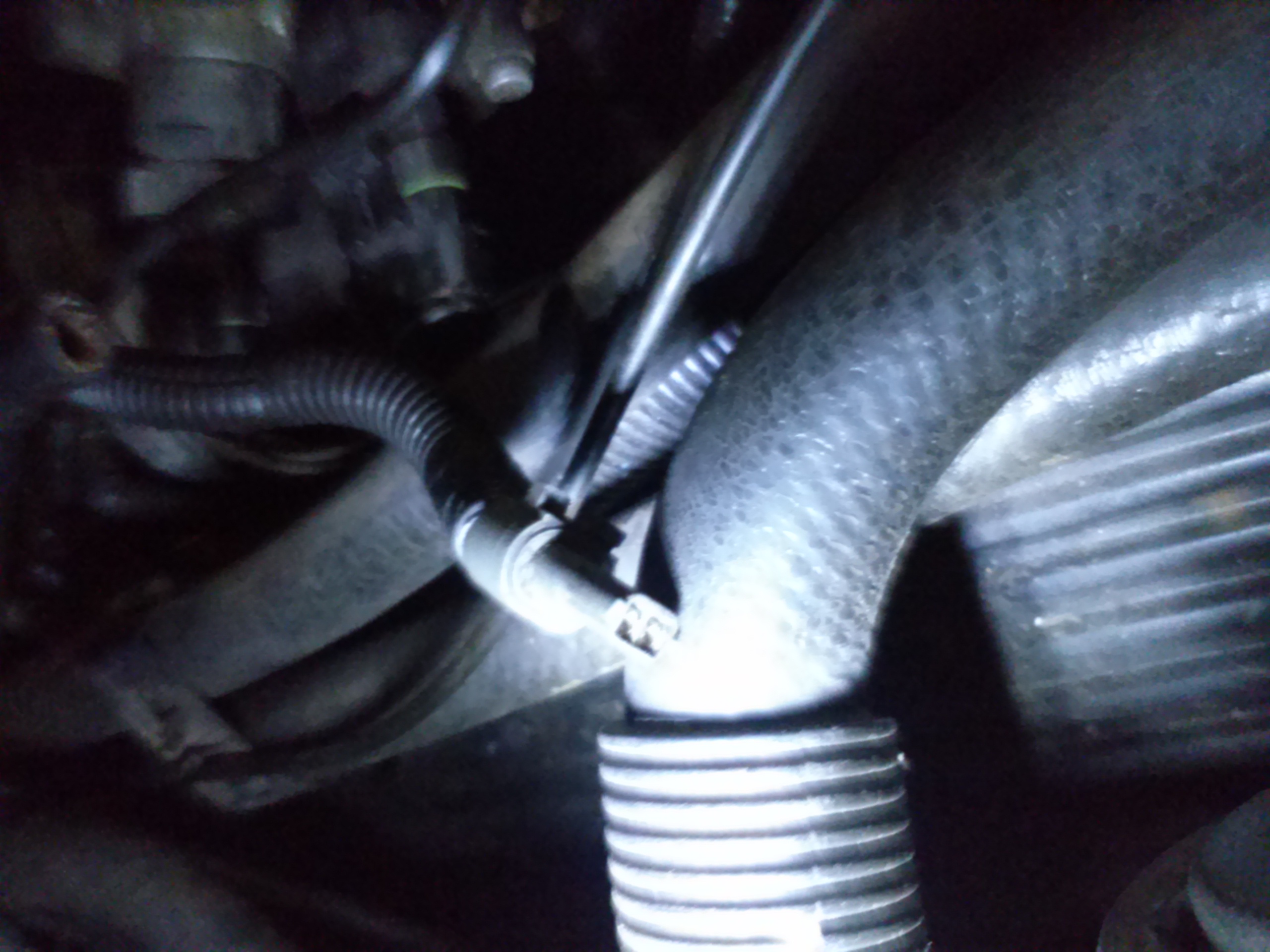

maybe pictures will help?

maybe y'all can tell me whats join on better now?
Attached Thumbnails help me here guys-cam00041.jpg   help me here guys-cam00044.jpg   help me here guys-cam00043.jpg

There’s no telling what wires the PO cut, spliced into the wrong places, etc.
But let’s get that that pump priming.
If the ECM is still in the car, and hasn’t had the important wires to it cut,
You can test it with a voltmeter.
There should be voltage on pin D of the Pump Relay
green wire with a
White stripe for 2 seconds when turning the key to RUN.
If repeating the test wait at least 10 seconds.
Was there power when you did that?
