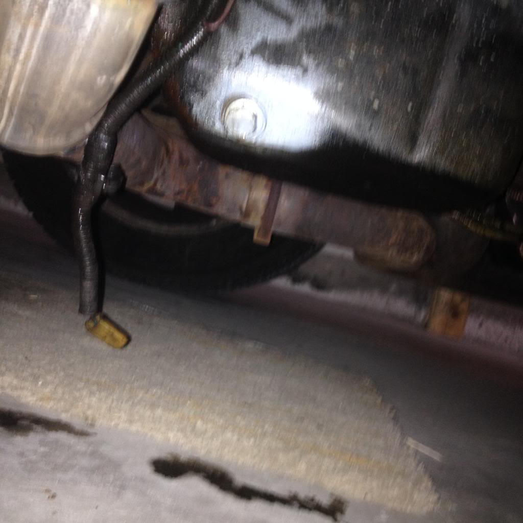

Anyone know what wire this is?!
Was looking under my car for a screw and noticed it , was at the shop few days ago cause i go some headers put in and never saw it...mayb it was tucked away and fell down? Thats what im hoping , whats it for!?

Looks like the temp sensor wire. It SHOULD be between the 1 & 3 spark plugs, but judging from where it's hanging, it looks like it will be between 6&8. Does your gauge work?

Its more on the drivers side but im gonna look and see cause it was working but haven't noticed since , mayb the guy who changed m headers forgot to reconnect it , thanks

Yup, coolant temp sensor wire

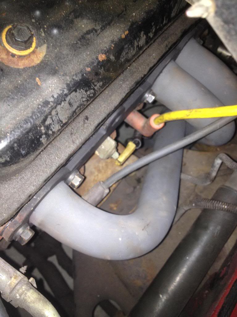

Yup couldnt get under so i fish hooked it up with a clothes hanger and hooked her on. Name:  46B8353E-9762-42C9-9728-A15DB0938BC5_zpset66ek5r.jpg
