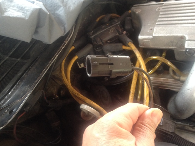

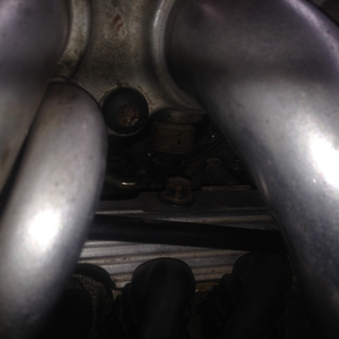

I am new in the forum and I'm from Chile.
I bought a 1986 trans am and after a year is almost ready to roll out into the street.
I have two problems with connectors.
1.-I have a connector that does not know where it´s.
2.-I can not find the MAT sensor connector and the wire.
PLs your help.

you hold the mat connector (tan and black wire). you picture mat sensor.
you are missing the stupid male to male jumper cable that lets you plug female connector to female mat sensor.

Thank you very much for the help, I thought it might be the cable but the connector was different. I never thought I was missing an adapter makes no sense to me ...
