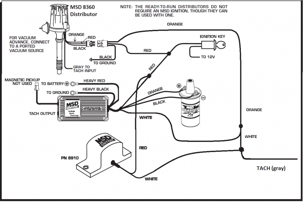

Just came it from the garage cant get the tach to work yet here's what I did no computer car no tach filter just 1 wire from the cowl hook up at d6 a white wire from there to the msd box an it still doesn't work car is a 87 iroc with carb. Thanks.

You may need a MSD tach filter. This pic is how I wired mine it may help

I have everything a msd dist coil an box 6al . according to msd book I shouldn't need nothing. lost

Are you using the Stock Tachometer or an After-market tach? Does the tach stay low, read high, or some where in-between?
Going off of what Midias said, and considering our charging systems the information here should be usefull (hopefully).
That link discusses the tach adapter, and gives a part number for use.
This is the Part discussed in the thread.
If the links don't work, here are the direct links:
http://www.msdignition.com/forum/showthread.php?t=2168
Part
http://www.msdignition.com/Products/...c_Trigger.aspx
