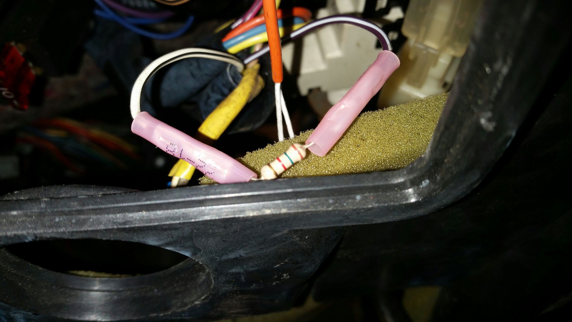

Old Apr 15, 2015 | 06:48 PM
poeboy's Avatar
Joined: Apr 2015
Posts: 10
From: gastonia, nc
Car: 1990 Pontiac firebird formula
Engine: 305 tbi
Re: Need help with a starting problem
Find this resistor and these 2 wires under the dash. And do what I did!! Problem solved!! Been working for 2 years. 90 firebird formula. White wire with black stripe and purple wire with white stripe. Cant remember what size resistor though....sorry! Hope this helps.
