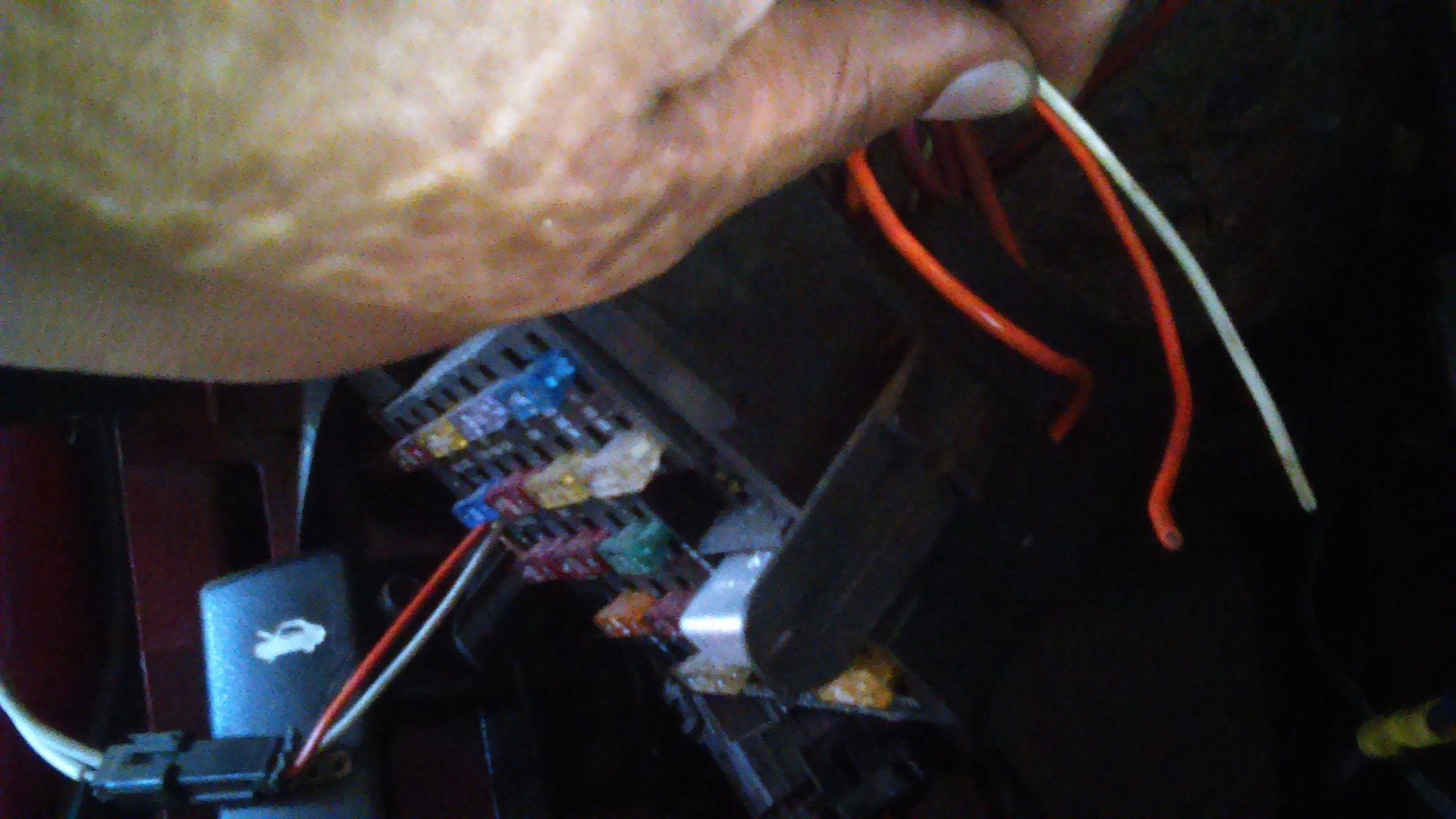

I just bought a 89 Camaro RS 2.8 and it hasn't been ran in awhile. I was cleaning up the interior and saw 2 wires just hanging near the fuse box. I need to know where it's supposed to be plugged in. Both are skinney , one is solid orange and the other is solid white .

Those wires used to connect to a small (#194 bulb) courtesy light that was in the underdash panel and lit up the footwell when the interior lights were turned on . If you don't want/need a light there , tape em up good so they won't short and call it done ....

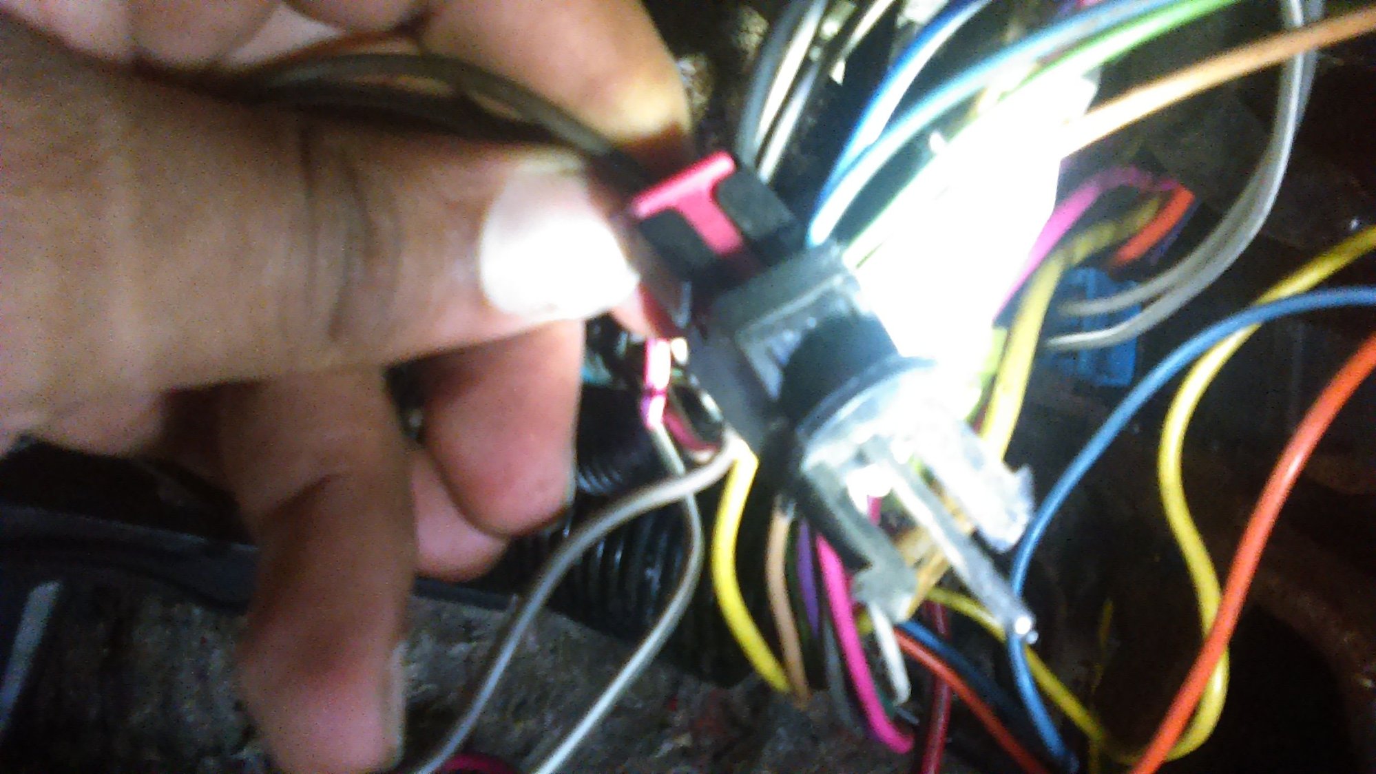

THANK YOU SO MUCH! I'm happy I joined, this car needs work and some stuff I just can't figure out alone. Got another question, I also found a connector near the fuse box that is unplugged and another black connector just hanging. Any idea what they do?
This one is very short
This one was right under the steering column.

If you can tell me the exact colors of the wires going to those disconnected plugs , I'll look at the wiring diagram and see if I can help you identify them . I will admit , I've seen most of what's under the dash of my firebird , and I don't recognize either of them . In picture two , it kinda looks like it could be the cruise control connection that would run from the steering column to the dash's harness (running from the switch on the turn signal to the dash wiring) but this is only a guess since I can't too clearly see the connector .

One wire is brown and the other is gray with a white line
