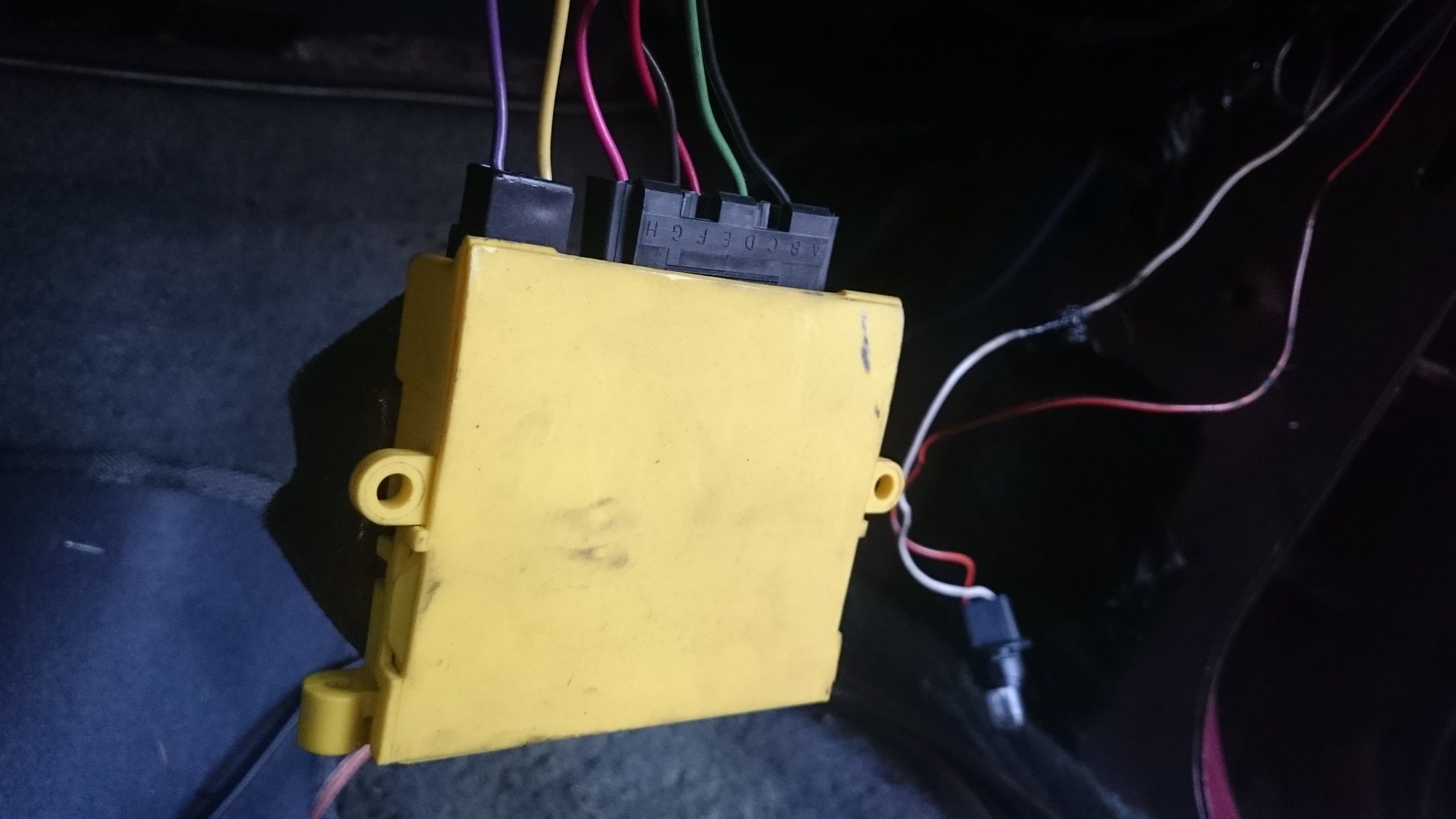

help. It started out a while back with no start then no crank.did the resistor to replace key trick,bypassed starter enable relay thought I was good then no start again.cranks OK,has spark,no injector pulse,no codes present and all sensors in range,battery voltage good.I believe I've located the vats and attaching pic to verify that's it and its authenticity. I got a bud bringing an oscilloscope. I've read I should be looking for a 40hz 5vdc sq pulse wave.I want to know if thats accurate, where to check it and if thats good how to verify ecm and icm input/outputs or any advice on which direction to go,thanks anybody.

The item in your picture is the "VSS Buffer" , and not the "VATS module"
