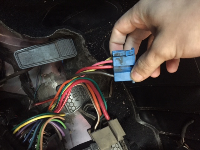

I have just completed my T56 swap on my 87 IROC 5.7 TPI. Unfortunately, I have these two connectors hanging under my steering column that I unplugged months ago (and of course was to dumb to document)..... I am really hoping someone can tell me where these two plugs go and where I can find their counterparts.

Ignition switch. Car wont run without them

Any idea where they plug in?

They plug into the ignition switch.
If memory serves, you have to plug in the blue one first; it has a tab that the black one sits on top of.

The ignition switch is on TOP of the steering column,

Thank you guys so much! The car is now up and running. "Why does it sound like we have a train in the garage?" - My roommate.
