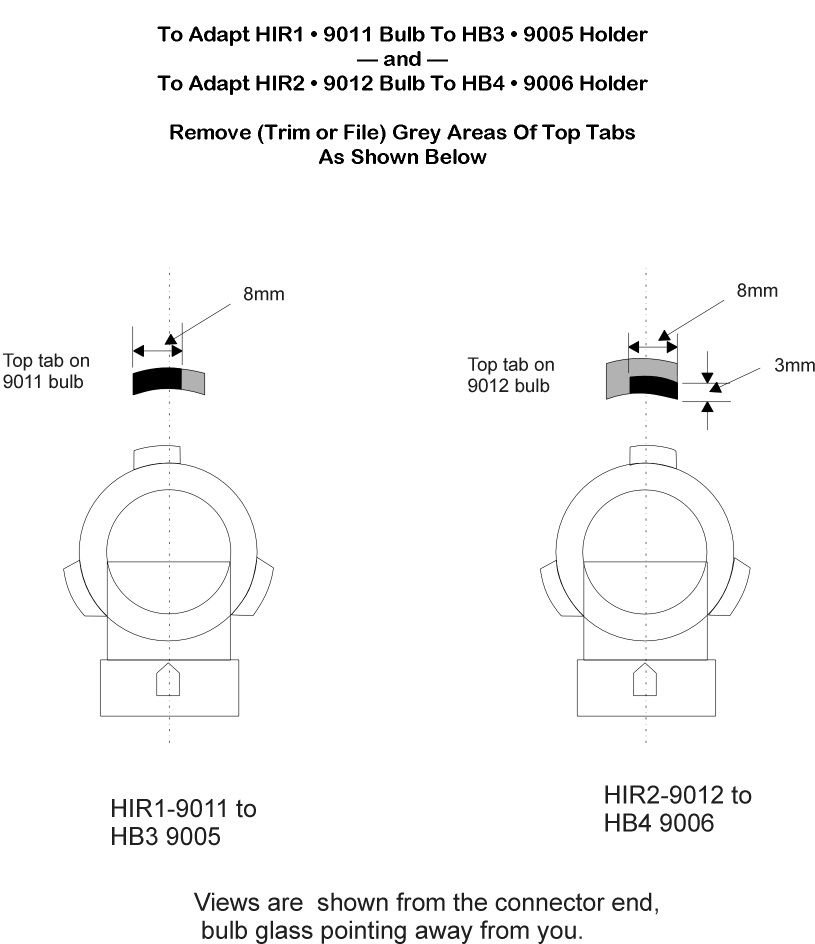

My DD (13 dodge dart) has 9012HIR2 bulbs and noticed people modded them for 9006 housings.
My question is: has anyone done this on a 3rd gen yet??
Seems like a great alternative to HID's.
see attached
