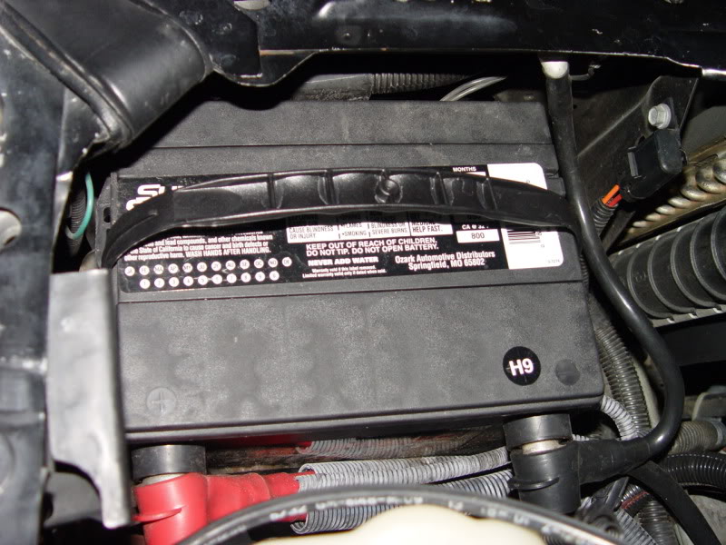

The extra black ground goes to the front of the car. I'll show some pictures.

The above are on the 89 GTA. I liked the Innovative Wiring kit so much, that I bought another one of his kits for our Blazer. Those pictures are below.

Awesome pics, and thanks for the reply. But what are the extra connectors for on the power side then? Alt, starter, and power block, whats with the 3 pin and 2 wire options? Just want to make sure I order the right one.
