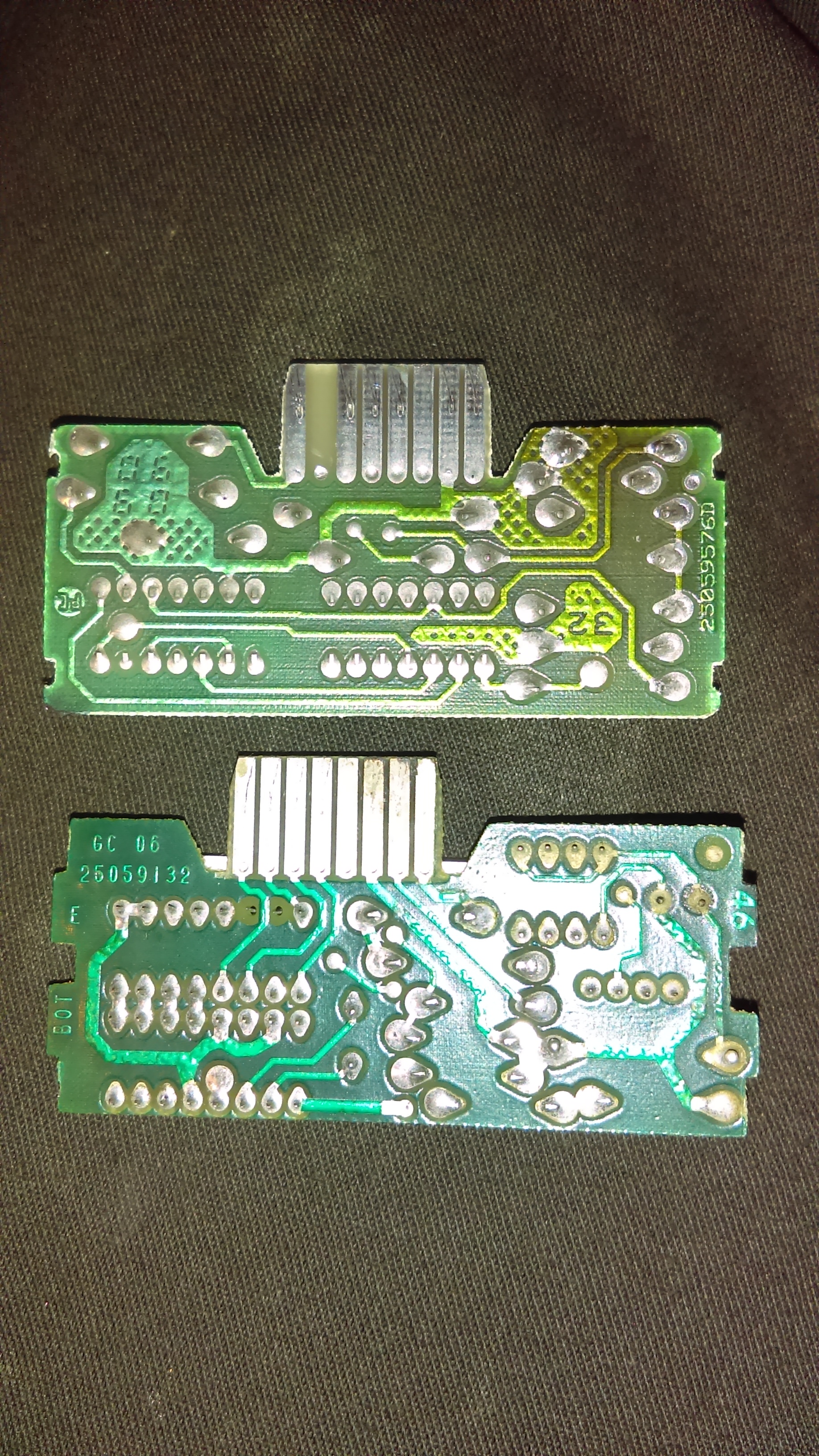

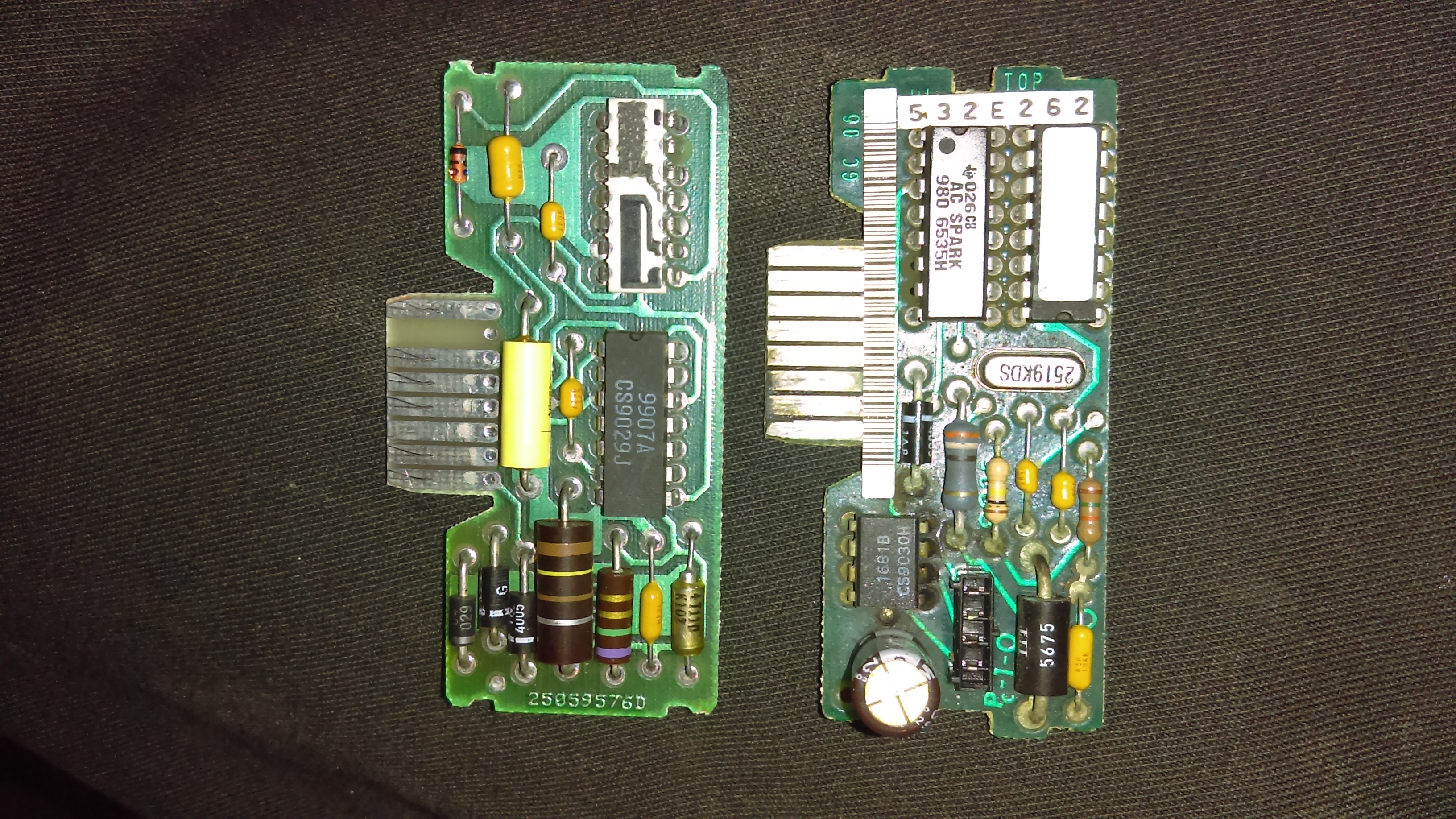

Alright. So I removed both circuit board s from the gauge cluster and they look pretty corroded. Another issue I had was that the PO had an aftermarket stereo and it was wired all weird and no lights worked on it at first. Got everything sorted out but after I bought another stereo and installed it, the right speaker was shorting out with the original speaker wire. So I ran new wires from head unit to speaker and it worked fine. After that when I turned my blinker on to the right the front light would stay solid and nothing happened to the rear light. Now, when I removed the circuit boards from the cluster, my blinkers are working fine. Is there anyway to replace the circuit boards?

There is a resistor on the board that is a common failure point on the later model electronic speedos. You may want to read up on how others diagnosed and repaired the board.
https://www.thirdgen.org/forums/elec...92-camaro.html

so I attempted to clean the circuit boards last night with alcohol and a small brush. cleaned up a bit but after I installed everything back on to test it, when I turn on my blinkers, the high beam indicator comes on but not the lights. so I will test all the connections and maybe take em to a pc shop to have them repaired.
