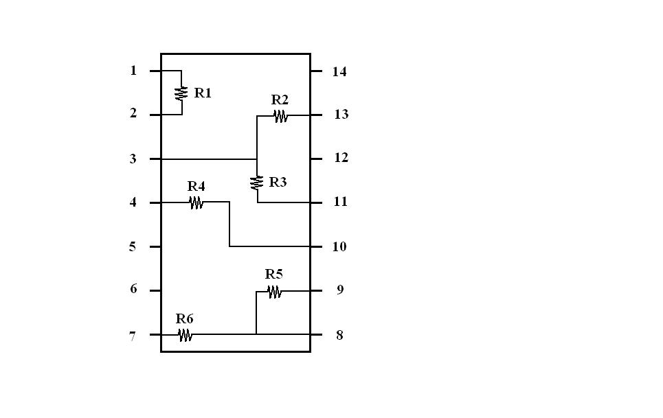

The resistor network consists of 6 resistors. Here is a schematic:

Here are the resistances for each resistor within the resistor networks for 5 tach boards that I have tested:

Both of the boards that peg the tach have no continuity across resistor 4. Also, regardless of the number of cylinders, all boards seem to have the same resistance values across resistors 2,3,5, and 6 (with the exception of resistor 1, although most boards are relatively close within 4.6k-4.9k ohms).
Interestingly enough, resistor 4 coresponds to the resistor on Oliver Scholz' article that is responsible for the needle deflection (in other words, its responsible for the tach calibration).

Those of you that want to fix your tach.....
Take your cluster apart, and gently remove the tach board. It will be the circuit board located underneath the tachometer. You will see a large 14 pin white and black chip on the tach board. This is referred to as the resistor network.
Take a look at how the pins are numbered in the picture below...
Old Jun 22, 2006 | 06:30 PM
92blue's Avatar
Former Sponsor
Joined: Feb 2002
Posts: 1,081
From: Florida
Car: 1992 Camaro RS
Engine: Yet another 350 TPI
Transmission: Borg Warner 6 spd
Disregard the picture above, the numbering for the pins is too hard to see. This one should be better....
The picture also shows the tach board with the newly added resistor.
Old Jun 22, 2006 | 06:52 PM
92blue's Avatar
Former Sponsor
Joined: Feb 2002
Posts: 1,081
From: Florida
Car: 1992 Camaro RS
Grab a voltmeter, and set the scale so that you can read over 100k ohms. Check the resistance across pins 4 and 10. If you have infinite resistance (no continuity), then the fix will be easier.
Infinite Resistance:
All you will need to do is solder a resistor across pins 4 and 10. I used a 150k ohm resistor, and the tach reads 7-8% lower than actual RPM. I believe the proper resistance will be close to 180k-190k ohms (More resistance makes the tach read higher, less resistance makes the tach read lower). Trim the resistor ends a bit to shorten the length, and then bend it in a U shape. Be sure not to get solder onto the adjacent pins. If you are not comfortable soldering, practice a little first before trying it on the tach board. Once you solder the resistor on the board, you can reinstall it into your gauge cluster. You might need to bend the resistor slightly to the side for adequate clearance once you go install it. Start your car, and you should notice your tach reading properly now.
Finite Resistance:
If you have resistance across pins 4 and 10, you will first need to isolate a portion of the resistor network. Using nippy cutters (available at Radio Shack), cut pins 4 and 10 very close to the circuit board. Carefully pry the pins upwards, away from the board. At this point, you can solder a resistor (again, I used a 150k ohm resistor which reads 7-8% low, a 180k-190k ohm resistor will be better) onto the contacts on the board which used to attach to pins 4 and 10. Be very careful not to get solder onto the adjacent pins. Also, the pins that were cut/bent out of the way must not touch the resistor that you installed. Once you soldered in your resistor, you are good to go. Install the tach board back in the car, and enjoy having a tach that actually works.
Note: The resistor values mentioned will work for a V8 application. I don't know what the proper values will be for a V6, but the fix should be the same.

okay everyone, I soldered 4 resistors together across pins 4 and 10, and the total resistor value ended up being 185.4k. I can tell you right now that its still too low a value, because it says the tranny shifts at about 4700 rpm at wot now, but I'll have to check that again tomorrow. I have a tbi so I think its supposed to shift at 5000. Ill try something close to 200k soon.

Yeah, using a potentiometer would be good to get the exact resistance you need. The only one I saw with enough resistance at radio shack was huge and rather heavy (heavier than the tach board itself).
How did you wire the resistors, in series or in parallel? If in series, then the resistance is additive. If its parallel, it works out differently.
Also, don't gauge how far the tach is by your shift point. Theres too many variables to get it right that way. I would suggest hooking up a scantool or laptop, that way you can compare the tach with actual engine rpm at a point higher than idle. The higher the RPM at which you analyze the two, the more accurate you will be.
