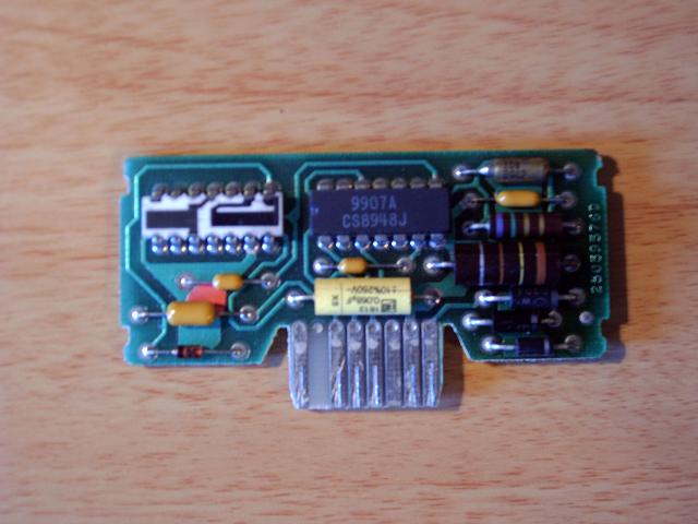

I beleive the problem with the '90-'92 tachometers is the small IC board that plugs into the instrument panel carrier. This part is not available new anywhere that I can find.
What signal does the tach generate?

Has anyone measured or seen what it looks like behind stock tach location...in regards to using an aftermarket in dash style tach in the hole?
Joined: Jun 2001
Posts: 9,550
From: Charleston, SC
Car: 91 Camaro Vert
Engine: 02 LS1, HX40
Transmission: 2002 LS1 M6
that said, i tried it, had it working on the bench, and broke the fugger before i ever got to put it in the car.
that kinda bummed me out, and i havent looked at it in months.
on a funny side note, my tach is almost dead accurate now... im feeding it a 2 pulse per revolution 5v signal.. (stock LS1 "tach" output..)
its purely coincidental, but since my tach was almost reading double, its pretty darn close now... my tach reads dead on on the low side, and when my 5800 shiftlight comes on, its reading a hair under 6k....

A side note to help with possible repair, anyone got a schematics for the stock dash/tach? Can't be to hard to figure out what is going bad.

Originally posted by NEEDAZ
Heck, even a bad tach and an LCR meter. From how they fail it's almost got to be a wayward capacitor, and likely the same cap. for all these tachs. One person poking around could help a LOT of people... I'll help with what I can over the net, I just don't have a bad dash (or mutch time, or a working LCR meter any more, they don't like 15KV...).
however, i cant figure out what chip it is... mine doesnt have any markings on it.

Let me start by saying that I've never looked at one of these dashes looking for a tach problems and I don't have one with a tach problem.
With that said, based off of other experience (a good bit of experience with industrial control tachs) this don't sound like an IC that failed. More like a capacitor is leaky. If you have or know someone that has an LCR meter it shouldn't be that hard to check the caps on the PCB. Shouldn't be more than a handful on there. I could be wrong, but got a good feeling about this one. I should add that LCR meters are woefully inadequate as 'cap testers', but should work with this failure. Question any cap that is more then 10% low. If you find more then one that is questionable, add a variable cap in parallel with one cap at a time (long leads), plug the dash back in and hold the revs as steady as you can. Twist the variable cap and see if the tach changes (the value of the variable cap will depend on the cap that you're putting it in parallel with). That should be the one that is bad.

I posted some info on this topic a few months ago. I have since then took the fugger apart to see what makes it tick. I bought the car NEW in 1991. The tach started reading higher than normal about 3 years ago. Little more each month. More. More. Then 5000 was shown at Idle, then 6000. Now it just stays at 2000 all the time the key is on. I took it apart and figured out how the 2 coils in the meter can position the needle anywhere (even 360 degrees!) and rigged up a microcontroller 2 channel PWM controller to position the needle, and it worked. I never finished it as far as installing it in the car, I just bought another tach and ignore the one in the dash. I can't believe that no one at my dealership has ever heard of the problem, and I certainly don't think it should be $250 to fix a $20 driver board. I'll try replacing a cap or 2 on mine and post the results.
Austin
1991 Camaro RS 5.0 TBI completely stock; 190,000 miles original engine no rebuild yet but needing one soon!
Austin

Originally posted by alhiggs
...and rigged up a microcontroller 2 channel PWM controller to position the needle, and it worked. ...
Holly cow man, talk about over kill, I LOVE IT. Take your time and you could probably make the stock tach (your tach controller and stk face) and have one heck of a fast, accurate 'stock looking' setup.
Obviously you have some electronics experience. Do you have an LCR meter?
I need to get a new LCR meter my self, anyone near MD got a bad dash for some checking?
Austin
Austin
if you want to fake a tach signal to the stock tach, you can just hold the pin high, and drop it for every pulse... the stock tach works fine on a 5v square wave input..
well... as fine as it works in the car.. lol.
ive tried replacing my caps... checked the resistors... theres this one unlabled IC that im pretty sure is the problem... but without a label, i cant look it up any further.
if anyone takes a cluster apart, and can read it, post up the part numbers on the chip!

hmm.
thanks.
it seems unlikely that would go bad, but thats what i suspect right now....
thoes values you have written in the pic above, are they the factory values, or are they what your read on your circuit?
thanks.
