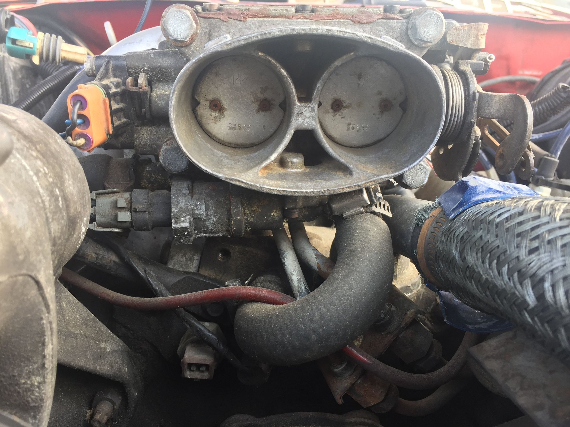

Where is my coolant temp sensor? Missing?
Hi Everyone,
I have a 91 z28 with the 350 TPI motor and for the life of me can't find this sensor for the ECM. Everyone says its next to the thermostat and is connected by two wires, Yellow and black. I hope someone can help me find it in the photo below.
This is what i'm working with.. Could it be the one that has no connector on it? This would explain a lot.

The one next to it with nothing plugged in is a cold start injector switch, which a 91 wouldn't have. Just fyi that something has been changed there.

Ah ha! Thank you! And yeah, a lot has been changed wiring wise lol My mission is to put it back to stock.
