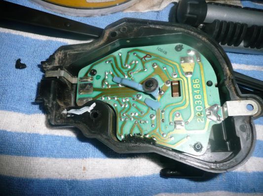

Sounds like a short on the delay circuit board. Can you pull the board cover and silicone around the perimeter. This use to be a fix for the c/k trucks after the cold solder joint was fixed on the circuit board.

Like drew said there are a few different motors. But if it has a cover like this you can remove it a silicone around the mating surfaces.

The rusty or corroded top edge needs to be cleaned and sealed properly.
Joe
What are you referring to. My reference picture ? The op hasn’t posted a pic of his motor !

Here is a picture under my hood. I thought by the way that piece was shaped Tuned, that it was just up and right from the carb in the picture. The plastic piece on my wiper motor is snapped on, not bolted on.
