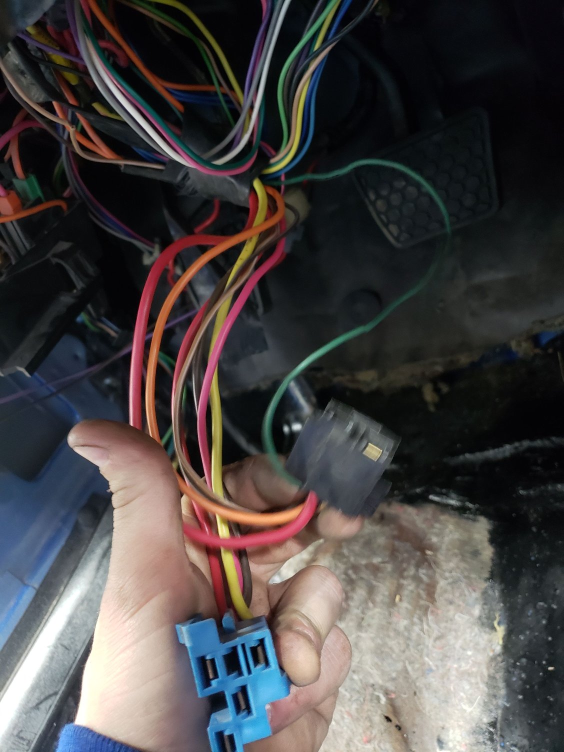

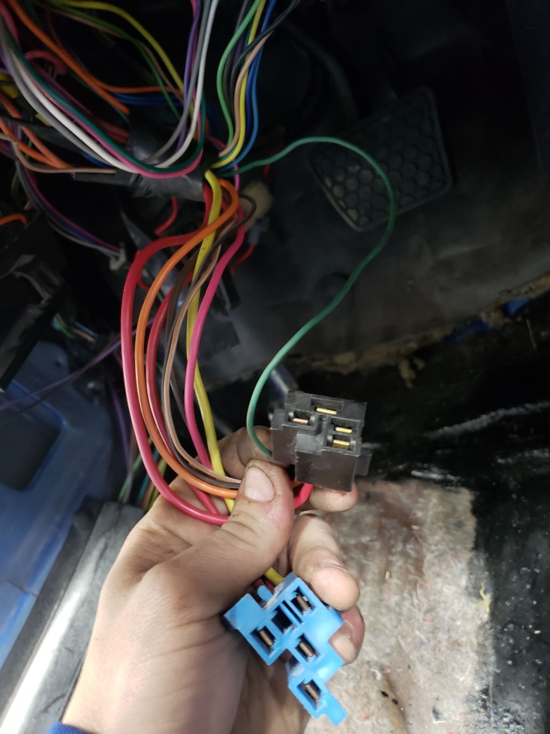

I have 2 connectors I can not figure out where they go. Any help would be awesome. Car is a 86 iroc had a 305 tpi and an auto. No motor is in it currently as I going carbed sbc and manual.

Those plug into your ignition switch , which is on top of the steering column down near where it passes by the brake pedal .
