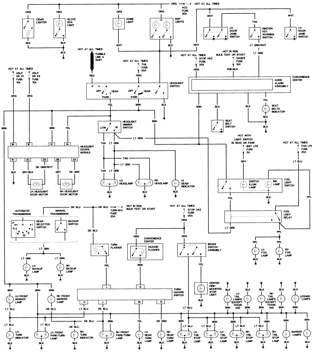

Time to bust out the voltmeter (or 12V automotive test light) !
Using this handy diagram the first check should be the red wire at the headlight switch , Is there power there ? If no , check the fusible link "A" shown feeding the red wire in the diagram . If yes , turn on the light switch and check the yellow wire , if no the switch is bad , if yes the next check will be the tan (low beam) or light green (high beam) wires going to the headlight bulbs themselves from the high/low beam switch . It's a fairly simple circuit and should be pretty easy to chase through to find where the power is and is not ....

That diagram will probably work if you're not easily distracted. The GM/Helm Service Manual has the pop-up circuit on one diagram, and the headlights on the other, another for the fog lights, another still for the tail lights, all with diagnostic charts to eliminate possibilities in a logical manner.

At first I thought the switch was bad but it turns out that power just wasn't going to it. After finding this out, I checked the fuse box to see if I missed a blown fuse but I didn't. Turns out Power isn't go to that specific fuse at all. I decided that I didn't want to deal with that quite yet so to get me by I found a random hot wire under the hood that was already exposed (previous owners didn't car about this car much) and I just ran wire from that random hot wire, through my firewall, and connected it to my switch. My headlights working and I didn't have to spend a dime, I see it as a job well done.
