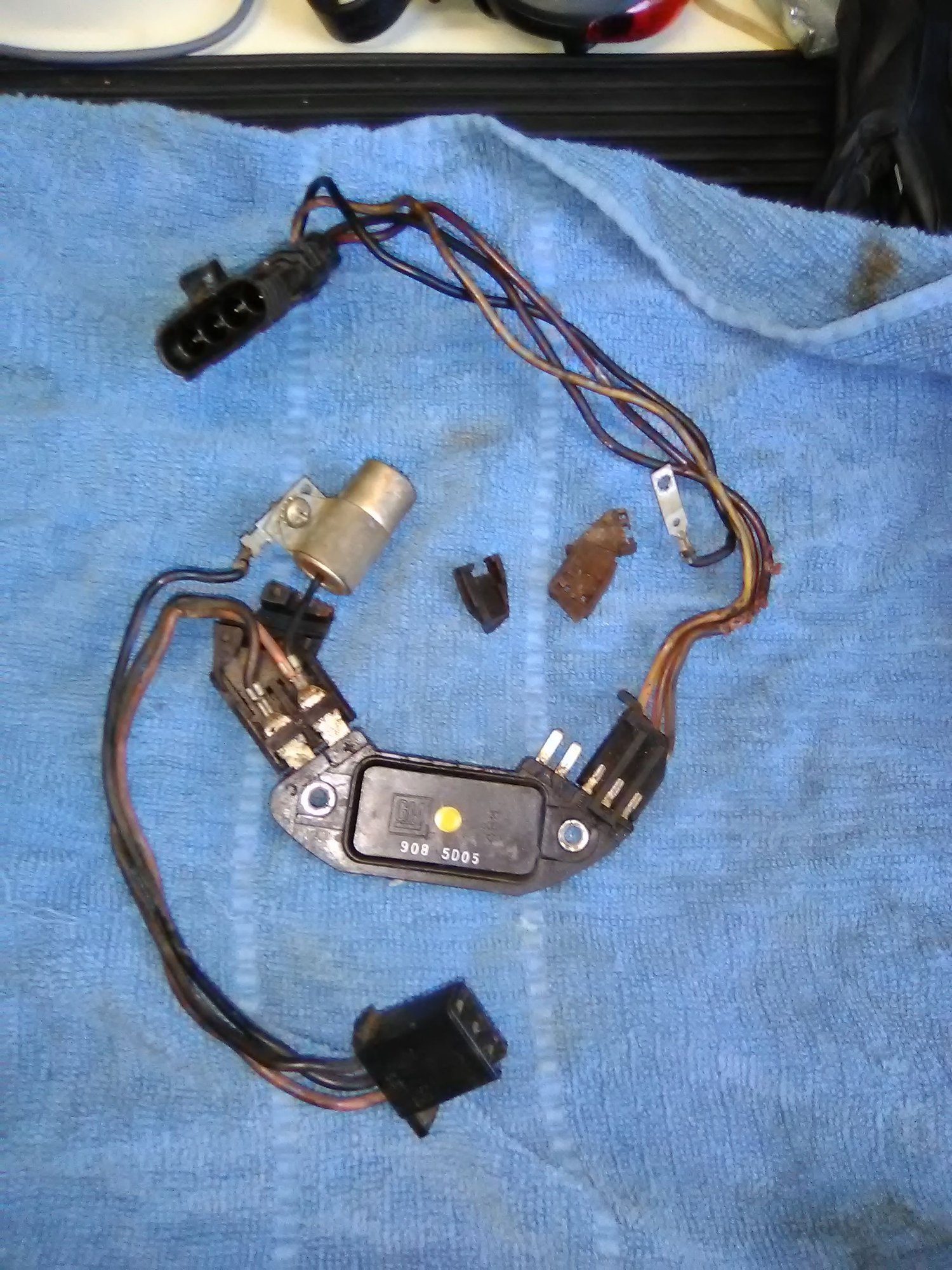

I've got an `85 IROC 5L TPI I'm working on. The internal distributor connections are toast. I need to replace the harness that connects the 7-pin control module to the harness that goes to the ECM. I can't seem to find a source for a replacement. I'm also having trouble even locating the proper distributor for the F code engine. I want to keep everything as stock as possible because it's a 1-in-205 built. I've included a pic of the distributor wiring for reference. Any help or ideas would be greatly appreciated!

When I did mine there was only one thing I couldn't get new, is the harness that goes into the dist with the plastic seal in lower left of the picture. Found a low mile part and used that.

I've seen that harness somewhere. Can't recall where. I'll keep my eyes open.
Distributor builders / rebuilders get em from somewhere as well.
There's nothing particularly unique about the TPI distributor, except that it's not as tall, so that it fits underneath that little cover thing in the back.
I wouldn't be quite so concerned about "originality", if the car doesn't run. An "original" lawn ornament on cinder blocks is still … a lawn ornament on cinder blocks. The value of "1 of 205", plus about $2.50, might be enough to buy you a cup of coffee. Not saying you should butcher it or any such; but at some point, ya gotta do the math.
You could always do the small-cap conversion; or, go buy a NICE NEW distributor that you CAN get and strip all the NICE NEW parts off of it, including that one, and move them over to yours. Think of ways to GET IT DONE, as opposed to complaining about why you CAN'T.

The capacitor (condenser) harness is available most everywhere. I looked for the ECM/EST harness but couldn't find anything. Cut and splice or wrecking yard?
After searching for a while, I got the impression that the internal coil distributor with the 7-pin ICM is an odd duck

No, the 7-pin thing was used on all the computer-controlled motors from 80 or 81, whenever they started it, through 86, In 87 they went to the small-cap divorced-coil setup. So there's LOTS of em around, or at least, were. The TPI version of it, both Vette and F-body, was shorter, so it would fit under the cover that's at the height of the plenum. Not sure whether the shaft is shorter or not, seems like it would have to be though. But the rest of the guts is all the same.

The 7-pin module and associated goodies is pretty much required for the computer setup... 2 for the coil and the +12V; 2 for the pickup coil; and 3 for the ESC.

Yeah, that's exactly the part I'm having trouble finding. Unfortunately, we don't have any wrecking yards near us that deal with older vehicles.

You would not remotely hurt the value by plugging in an adapter harness and running a divorced coil distributor. The divorced coil distributor is even more common than dirt. Keep an eye out for the piece you need while actually driving and enjoying the car. When one turns up, finish rebuilding the original distributor, toss it in a box on the shelf, when you're ready to sell to the dipstck collector that will only settle for a super duper rare limited edition collector car with the original style distributor, 'you know what you've got', you can pop that junk back in and ride it all the way to the bank.

Looking at the photos of your distributor, that's pretty much what you need; as you yourself said...
which seems to state rather clearly that you are entirely willing to purchase one, actively searching for it even. So don't get all bowed up about a suggestion of buying a distributor you DON'T have trouble locating.
Changing out just that one part might, just maybe, get it back running again. OTOH the connector on the primary harness (3 wires; pink, black brown) is broken too, and the wires are kinked, possibly with broken strands inside them or ready to split open and create shorts like the ECM one. The connector that plugs in right next to the one you're asking about, for the pickup coil, is made of the exact same material and has been there for the exact same length of time subject to the exact same conditions, and is therefore likely to fail the exact same way as you reassemble it. The pickup coil itself is made of the same stuff as well, and is known to fail that way. And so on...
A "nice new distributor" is around $100. You could even buy one that says "Delco" or "Delphi" (the GM spinoff that owns the Delco brand name) on it, and spend an extra $20 or whatever, if that's what you want. You can take ALL of those fragile, worn-out, deteriorated plastic, and otherwise no longer reliable parts off and move them over to yours, and with careful disassembly and reassembly, (in particular, filing the burrs off of the end of the shaft and cleaning it so it comes out easily without damaging the bushing) have in essence a nice new 85 TPI distributor WITHOUT having to actually find one, rather than a time bomb. You could probably even knock the bushings out of the housing and transfer them over, with a little ingenuity.
