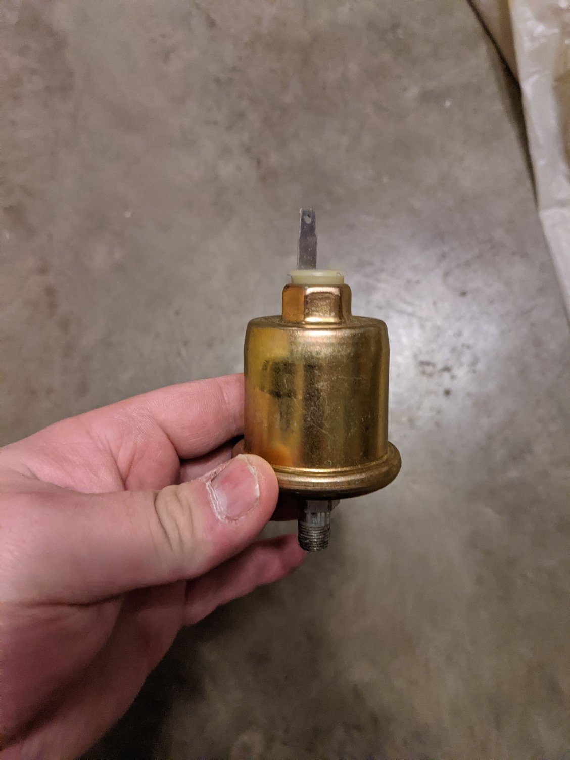

for the oil pressure sender you're looking for a tan wire leading to a dome shape device behind your plenum on the back of the block attached to a pipe fitting. It should have one wire connector on it. that dome shaped device is your oil pressure sending unit for the gauge.
Using the same procedure above the results should be the opposite for the oil pressure gauge.
See the attached picture out of my 87 electrical manual. The procedure should be similar if not the same for the 88. Also attached to the picture of a oil pressure sending unit for reference. If you determine that yours is bad make sure you get one for the range of your gauge. there are two for a car one for a 60 PSI and one for an 80 psi gauge. The one for my car for example was 60 PSI.
