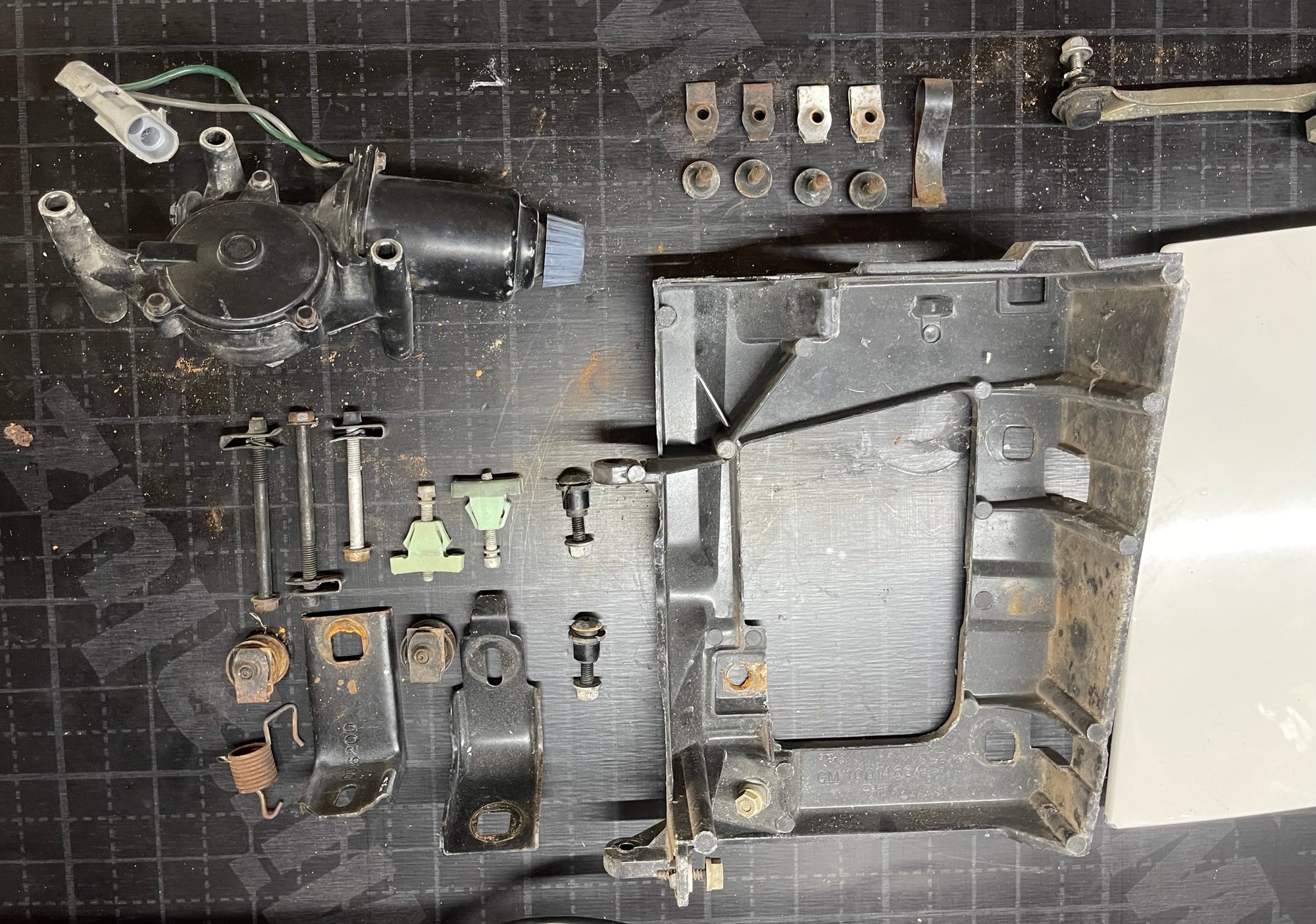

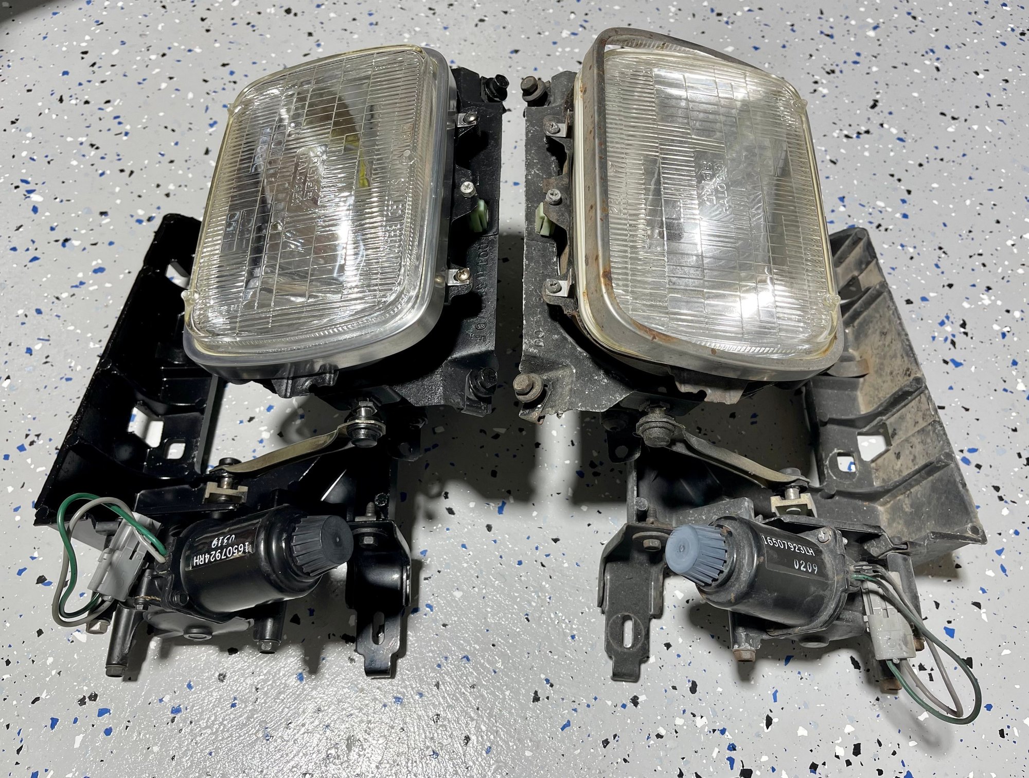

Im restoring a 89 gta se. when I got the car the lights wouldn’t move.
before and after
after a complete overhaul of the headlights they go up when I turn them on, but wont go down when I turn them off.
they both do the same so I asume the problem is somewhere else.
any ideas?

Whily you have the headlights apart, I would look at the rebuild kits at TDS. inside the motor housings are bushings that disintegrate over time. Yes, I said disintegrate. They turn to powder, as they are some form of soft rubber-like material. The kit is cheap as long as your large white gear is still in good shape. The hardest part is keeping the motor brushed depressed while reassembling. A paperclip and some time worked best for me.
https://www.top-downsolutions.com/he...ght-repair-kit
Old Aug 4, 2021 | 08:40 PM
Alexcoqui's Avatar
Joined: Jun 2003
Posts: 409
From: Manati, PR
Car: Trans Am "GTA"
Re: lights don't go down
yes, that was done to the motors. and you are right when I opened them all I found was plastic sand.
when I got the car the lights where stuck in the open position. now they go up when I hit the switch, but wont go down so I have to do it manually.
