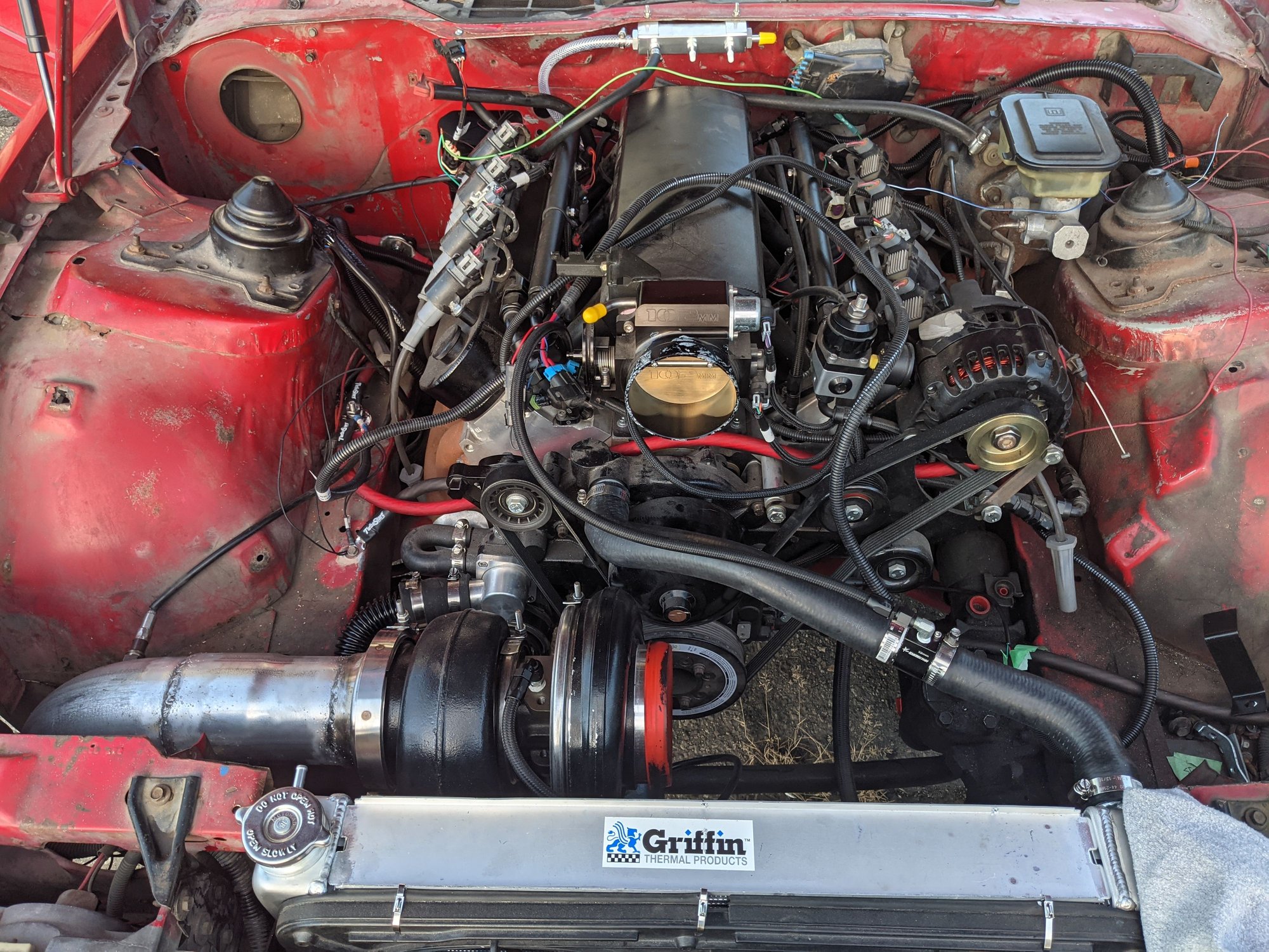

Hey guys I've got an issue with my 91 Z, so I just buttoned up the rest of my build and wanted to get it running. It's a forged 370 LS 80mm turbo, 4l80e with a Holley Dominator controlling it. I'm also running a Racetronix fuel system dual 340 in tank pumps. So I got all my wiring where it needed to be for the dominator I used all the same conect points I used with my HP system I had on the car years ago.
I finally go to turn the key and I've got power but that's it, there's no crank, and no fuel pump prime. So I pull the starter relay and jump the 2 thick wires together and now the motor cranks, but still no fuel pump prime. I'm still using the factory relay and wiring and just hook my Holley trigger wire up to my grn/wht wire on the factory stuff just like I did with my HP unit. I pull the bulkhead from under the car and test that and no power. I've got power at the orange wire on the relay but I guess that's as far as it makes it. I've even jumped the orange wire to grey wire and checked the rear bulkhead and nothing.
Anybody have any ideas what I should try next?? Granted the car is 30 years old now so if the consensus is to just replace wiring then that's what I'll do. Just a little bummed out as it's taken me like 5 years to get to this point.
